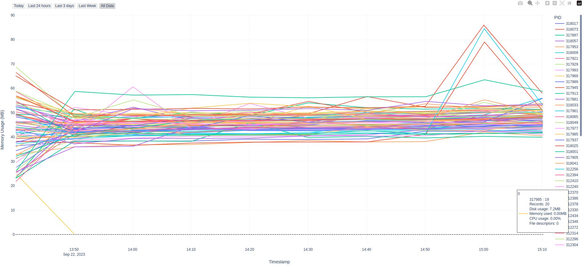

I’m getting this on all of the 10 nodes I have running on Hetzner
One of my nodes got killed after receiving 20 records.
Anyone else got the boot?
