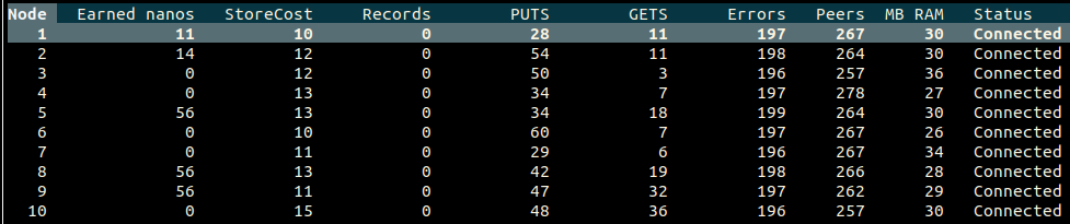

After twenty minutes here are my ten nodes.
First obvious thing to observer is more peers (>250 instead of <150) but presumably the reporting is more accurate?
[Also note vdash can now display records stored, but you’ll have to wait for a new safenode version before the data makes it into the logfiles]
I know its early doors but rewards are looking more evenly spread and ram usage is also looking pretty sweet :slight_smile:

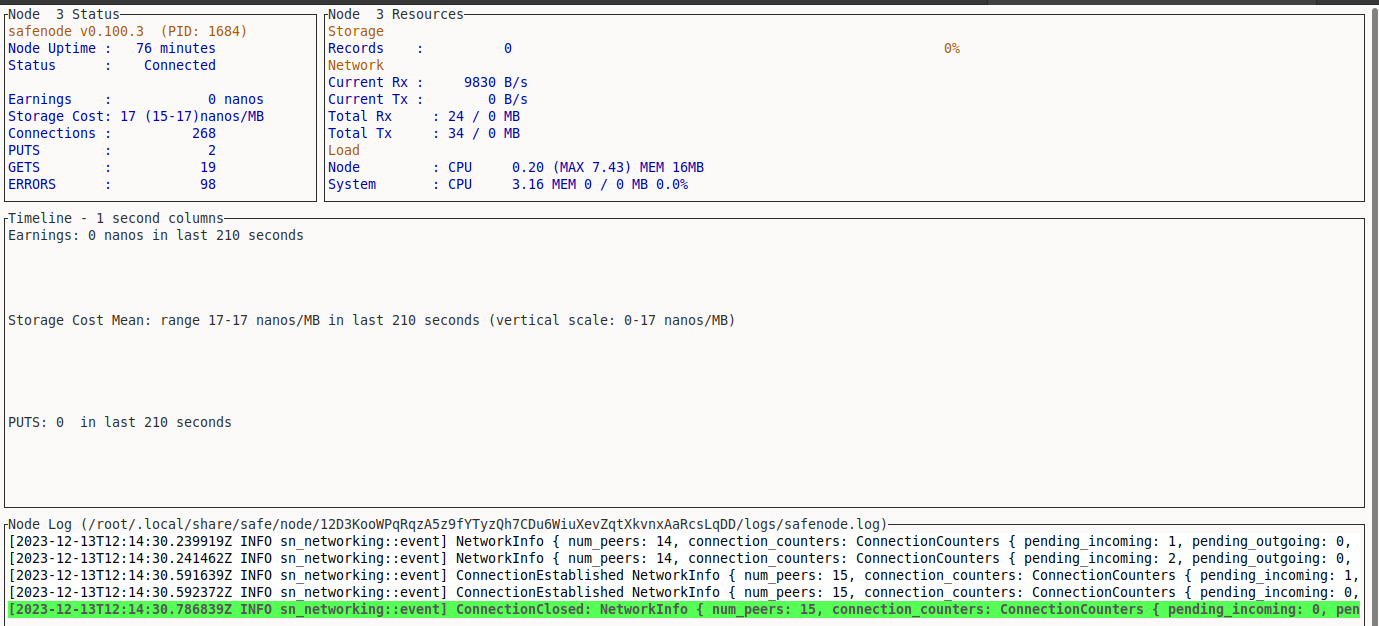

Not sure vdash (latest version) is picking up all PUTs @happybeing. All my nodes have several dozen records but it’s only counting 1 or 2 in each case. Or is it now differentiating between replicas and paid chunks?
