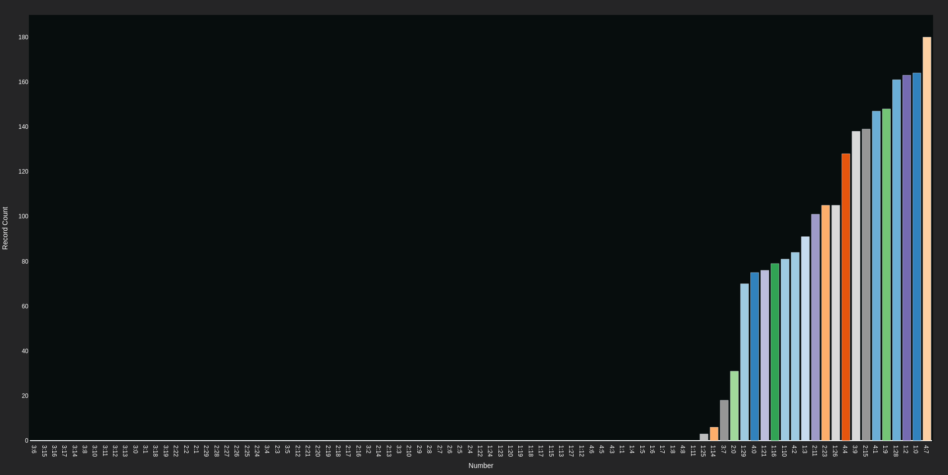

Has anyone noticed any nodes that are not recieving chunks? I have a bunch after running since just about the start, unusual.
Works good from home here
Yeah I didn’t clean up properly after last time. OK now
Me too, my nodes have been running 4 hours (since fairly soon after start) and only 6/20 have chunks. It was just two in the first few minutes but has increased gradually.
Seems an old issue has resurfaced, I think. Those that did not have records shortly after still don’t. But who knows, late bloomers perhaps.

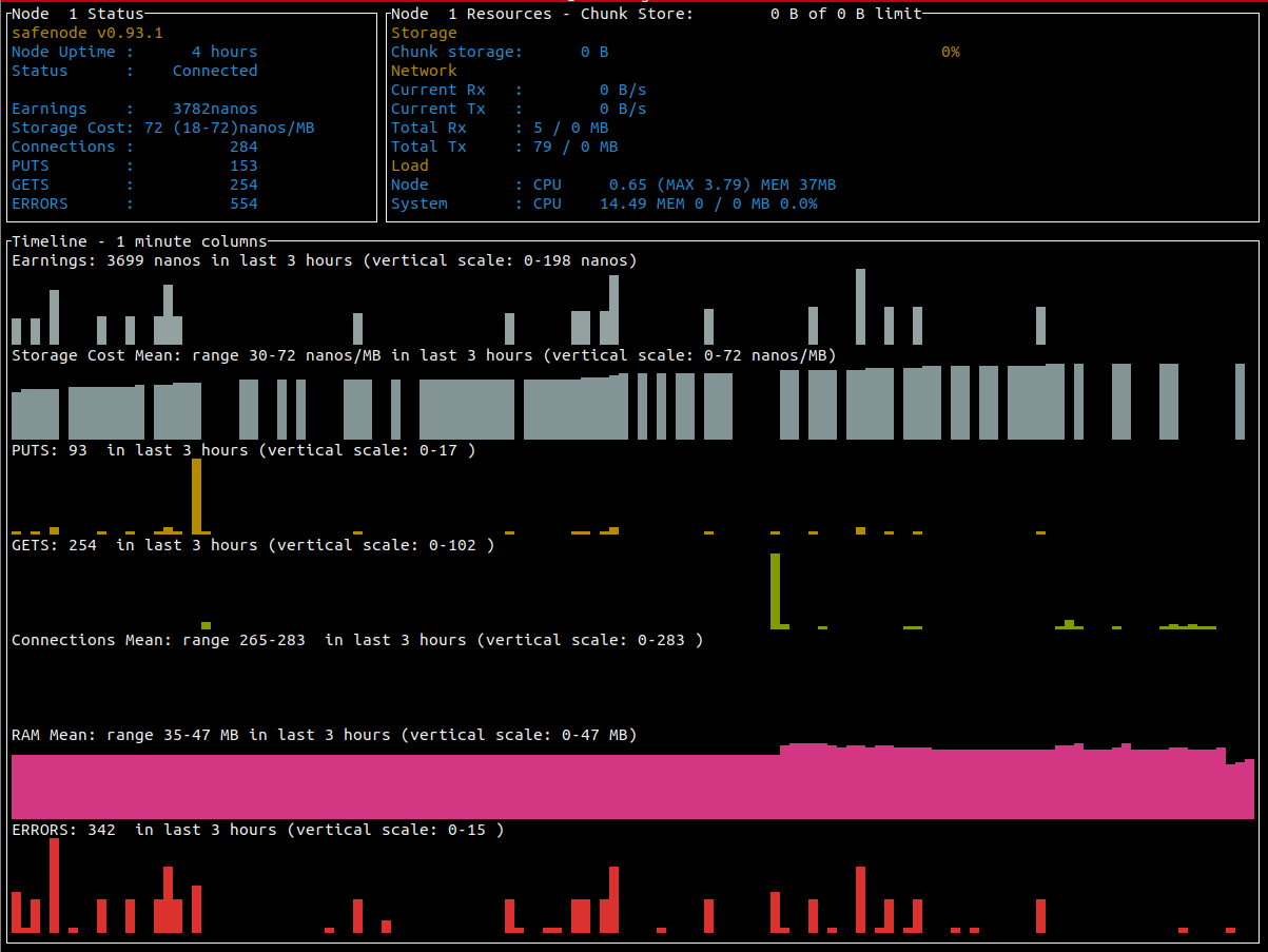

vdash v0.11.2 has a new feature allowing you to show all available timelines instead of the logfile…
And here is the updated Summary for my 20 nodes after 4 hours:
