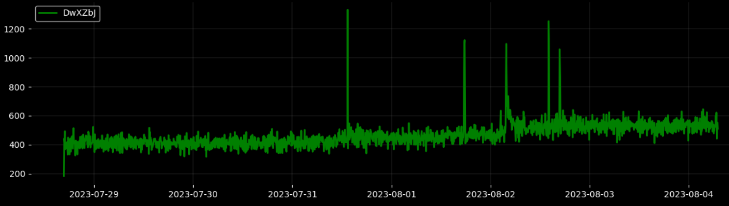

I lost another node yesterday around 4 AM, not sure why. Memory usage on 6 remaining nodes is this:
It’s odd that you’ve lost a node without oom-kill killing it because of low RAM on your machine. I wonder if there is something in the logs at the end that would be useful?
You could find which safenode is missing by running:-
lsof | grep safenode.log
(assuming that is where you stored the logs)
and looking for which numbered safenode is missing.
I know which one was it, I just didn’t see what went wrong. I searched the logs again and there was another network activity spike at that time together with a memory usage spike and it died because of not enough memory.
