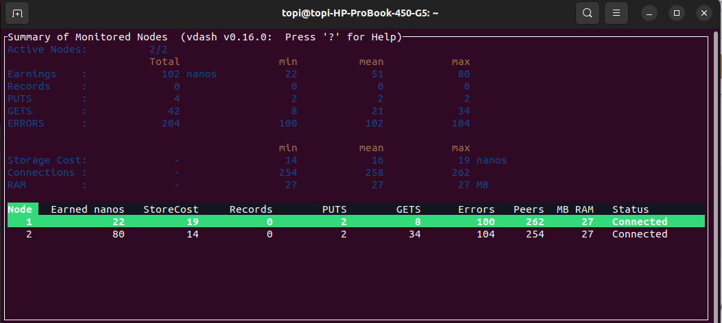

@happybeing Vdash is showing me 2 PUTs for both of my 2 nodes, but the record store folders have about 80 items each.

@JPL and @Toivo thanks for your reports. Please can you try the following and see what happens (maybe pipe the output in to wc -l to count the matches):
grep -e "Wrote record\|ValidSpendRecordPutFromNetwork" ~/.local/share/safe/node/*/logs/safenode.log*
Is anyone else seeing very few PUTS in vdash and if not, what version are you running?
I got 5 of them, which matches the numberd on Vdash.
10 for my three nodes. Same as per vdash.
