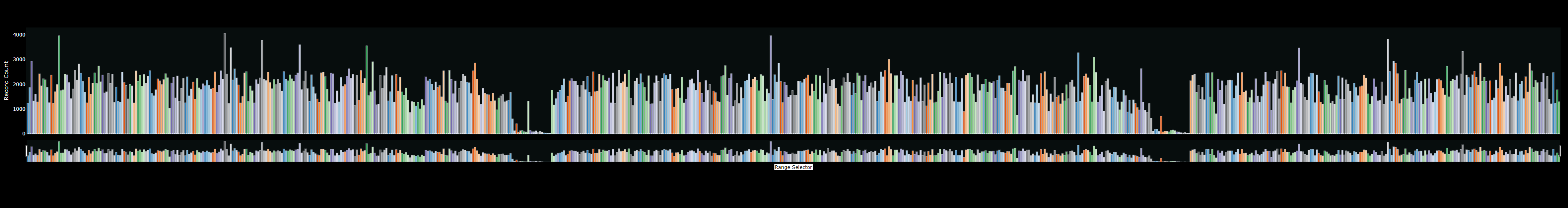

The average record count looks to be above 2k.
Could this be what caused the turning point in performance along side the churn from new nodes.
I know the limit has been removed so maybe not but idk?
Also noticing that between those despite the average being 2k-ish there are few that are almost empty.
I think it is not only new nodes to blame, going to keep yelling free tokens bad from my soapbox.
iv noticed two vps’s are not receiving as many records as the rest interestingly the two nodes @qi_ma mentioned above that were misbehaving and are now terminated one was on each of these vps’s.
the vps’s are showing up in my record count as the black gaps in this bar graph.
just considering shutting down those vps’s any thoughts @joshuef @qi_ma
