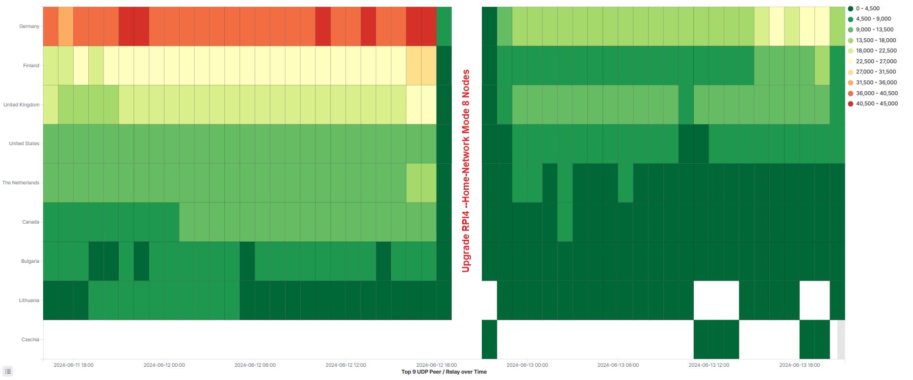

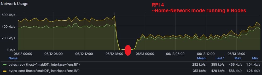

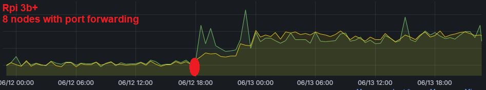

I know it’s still Beta, but I’m curious about how the relay peers are selected ?
tl;dr; my Pi3 running 8 nodes has --port set. Before the upgrade it’s network usage was about inline with my Pi4 node running --home-network
Now it’s upgraded, the Pi3 network usage has jumped up impacting %CPU to the point where I’ve had to drop it to 6 nodes.
I like to run with --port as it feels like I’m providing resources, but the poor Pi would benefit from some limits as it’s not as beefy as some of the other X64 machines people seem to be using.
  • Should I be using --port on Arm ? or leave that up to big setups to relay ?
  • If we can use port, than maybe a compile time max relay peers for Arm to limit the load would really help, and maybe a max rate limiter (there’s a nice implementation in GoLang, not sure if there is a rust equivalent)
But it’s all good :slight_smile: can’t wait until we can start upload testing! Also, The Pi4 with --home-network has much better relay distribution now, before upgrade it was all to a few ranges, and now much more distributed :+1:
Well done, really great progress and such a nice community, can’t wait to see where this goes.
HeatMap of Relay peers before upgrade, and after…
