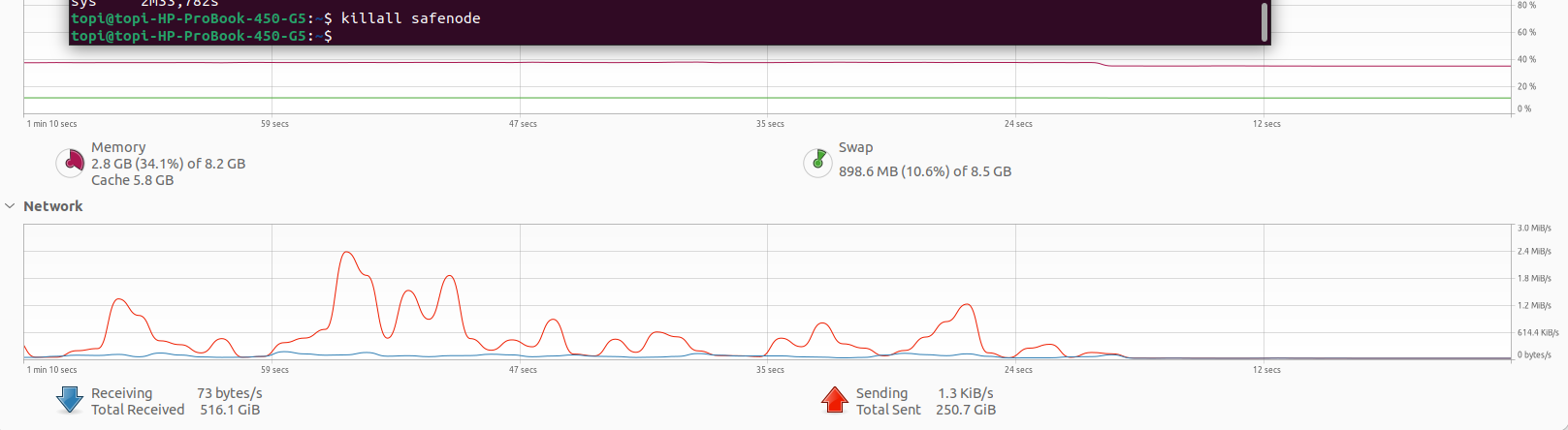

Same thing today. But it finds the initial 5 peers rather quickly. I wonder who are the other morons still having their nodes running? :eyes:
I’m gonna kill my nodes now.
Funny thing there’s about one GET per second going on, according to Vdash. And it seems to reflect the network activity graphs in my system monitor. OK, let’s see what happens when I kill my nodes… Yep, it stopped the upload. So my nodes were really sending chunks somewhere.
