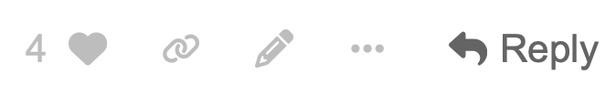

There should be an option to edit the post. Look for a pencil icon in the bar at the bottom.
Then you just have to make sure that the bits you want to be like this are enclosed in 3 of these `
Thats a freshly installed Debian OS and first node installed.. Reboot didnt fix it.. Tried as user and also as root.. everytime same issue.
I dont have options as shown in your posted screenshot to edit the post.
You will when you have been here for a little longer. Read some topics and you will progress in the forum’s trust levels.
