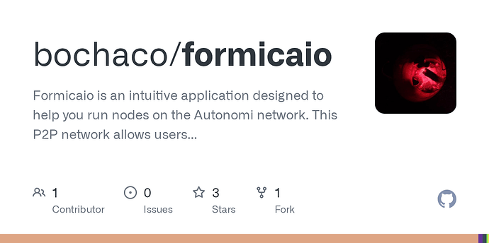

Use formicaio from @bochaco
I like to use nohup with it.
After unzipping to ~/formicaio I run nohup ./formicaio start &
hit return, let it do its thing for a min and then go to
localhost:52100
Hit the + in the bottom right and start some nodes.
If I want to see whats happening at the app level then
tail -f ~/formicaio/nohup.out will tell me
