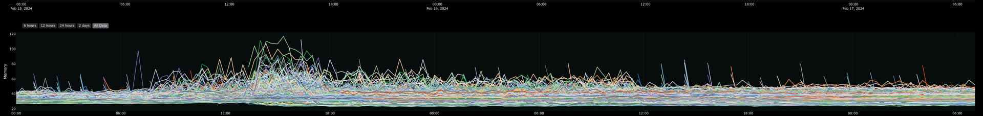

can see the memory usage settle down at the time I killed vps 6 and vps 15 and @Josh killed off his nodes that were not receiving as many records as the rest @ 1200 on the 16th
Downloaded in 6m20s. I just used whatever the default options are for downloading in batches.
Maybe whatever the issue was with the download that @Toivo tried earlier was just because the network was going through some turmoil at the time and it would be worth trying again.
Nah I was being a dunce, the 4 in question with very little records in my case were the 4 that died when my nodes were trying to catch up due to a late start.
