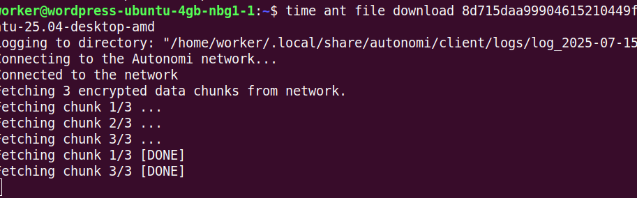

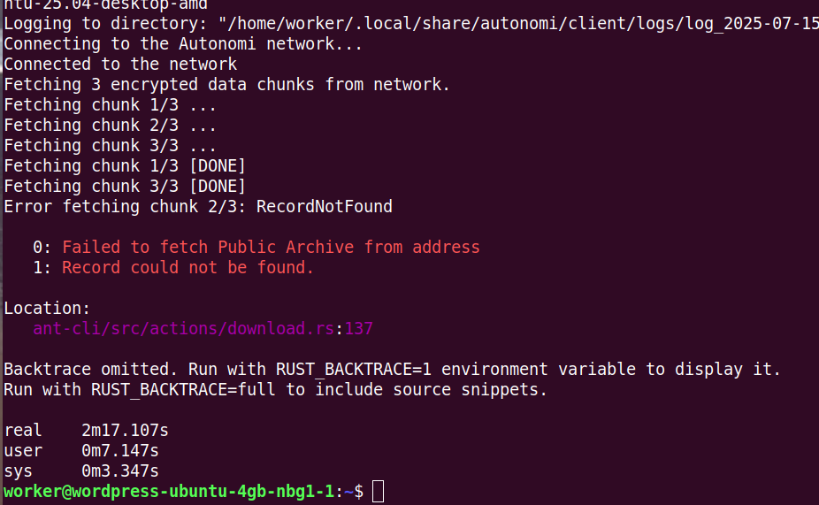

but shock horror - mere seconds later…
EDIT - this worked fine later when I set
export CHUNK_DOWNLOAD_BATCH_SIZE=24
try
export CHUNK_DOWNLOAD_BATCH_SIZE=8
to start with iv got 1gbps fibre and a Mikrotik router
24 is my sweet spot i downloaded the same file multiple times with different values till i found the number with best speed and before the errors start.
I just want to note, that test file is 6GB. However, we do still have the issue with downloading larger files, which is that all files get processed in memory, so you can see an issue if you don’t have enough memory to process those. This will be fixed shortly.
@Southside
If you don’t have a big connection, use a chunk download size of 1, and the file download command now has a --retries argument. Try using --retries 20. That is the combination I use on my stone-age connection and I can get downloads with either none or very little errors, like one chunk out of hundreds/thousands.
That failure was from a Hetzner VPS so it should be fairly quick
I would increase the --retries value.

Right, thanks.
Bear in mind also it is a large file. I noticed 4gb in your hostname, and that file is 6GB. Unfortunately we have not yet converted the downloading mechanism to streaming, so you need lots of memory to download a file that large. Should be coming very soon though.
