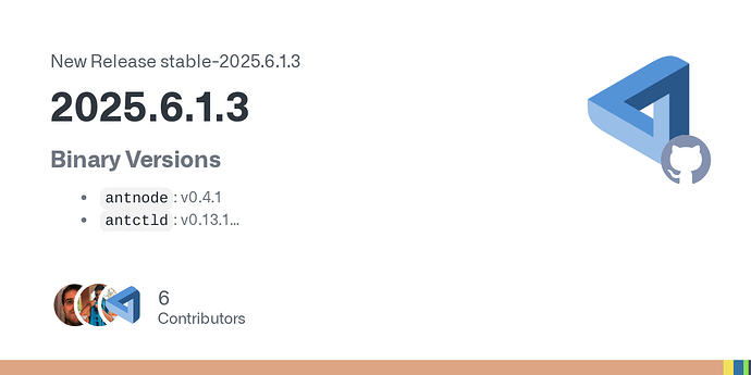

Binary Versions:
  • antnode: v0.4.1
  • antctld: v0.13.1
  • antctl: v0.13.1
  • ant: v0.4.2
  • nat-detection: v0.2.21
  • node-launchpad: v0.5.10

The detailed changelog has now been provided:
