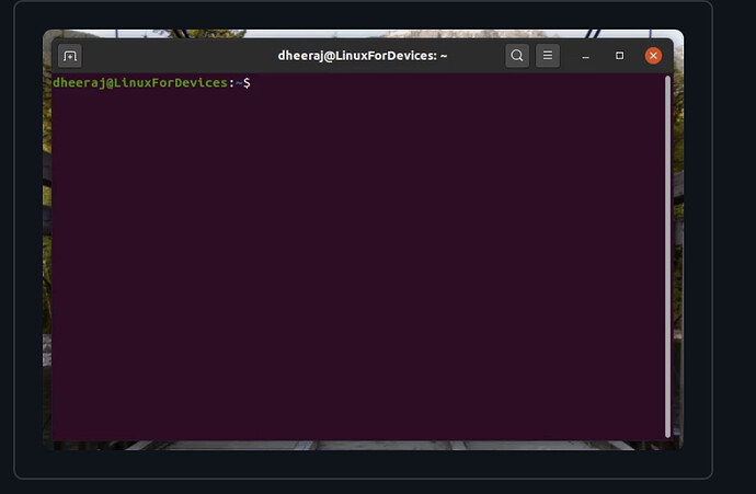

  1. Press control, alt, t to open a terminal.
(This is what the terminal window looks like but the writing before the $ icon will be different for each user as it’s your computer name.)
