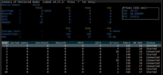

vdash 0.17.2 should work fine with that - let me know if you try and it shows records. My nodes aren’t and I don’t have that message in the log yet. :man_shrugging:

EDIT: In the past my nodes showed records instantly but this time it took minutes (not sure how many). Looking again after 46mins, all my nodes have sprung into life!
If anyone sees records in vdash with this new alpha, or can search for QuotingMetrics as above I’d be interested.
The log looks different than before but something still seems off @joshuef Here’s a log:
safenode-alpha.zip (22.7 KB)
Here’s the summary after 12m:

Looking again after 46mins, all my nodes have sprung into life! I don’t know exactly how long they took to receive records though.
Here they are after 50mins:
