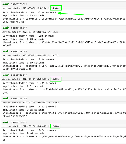

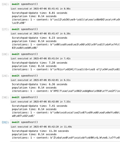

a funny plot twist now in scratchpad performance.
  1. they got even slower in roundtrip time … I didn’t manage to perform a singled successful handshake anymore before timeouts are hitting. (it just connected :smiley: so when being patient and lucky it might connect eventually via scratchpads; I think I’ll still revert back to handshake-server until the network has resolved this issue consistently (for more than a week of continued running) )
  2. funnily now it’s the write operation that consumes most of the time (as you can see in my last screenshot: after the network upgrade the write operation did finish very fast and we just polled a couple of times until the new state was populated. as you can see here now - the write now takes forever but then the first iteration of the read returns the new state :open_mouth: …)
very very strange … this is from cloud … when running friends on 2 machines in my network I’m seeing consistently communication times of >20 seconds per direction … so >40seconds to communicate back and forth once … which is not fast enough anymore to create a successful webrtc handshake reliably …

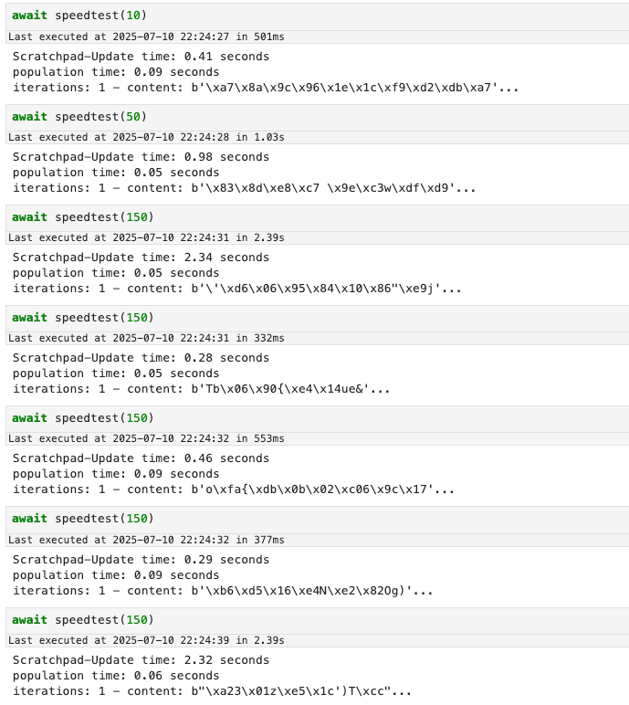

that flip to writes taking longer is not going away - but the numbers are smaller again and one friends reconnect I did to check if the situation changed for me finished on first attempt over here :open_mouth: (it was reeeally close - but still it was on first attempt and the timeouts didn’t hit)
now this is spectacular
(the argument number there is the amount of bytes - on previous tests it was hard-coded to 50 or so … now it’s variable - but we’re back to fast scratchpads :tada: )
That looks very fast indeed. What do you think changed to make this so much faster than before?
… maybe people recognized their machines were intolerable slow …? … maybe the network started to ignore those super-slow nodes …? …
my suspicion was that it’s slow due to overloaded nodes … and now I’d suspect that somehow we got rid of them (maybe because heavily overloaded nodes don’t earn as well ..?) ..
… sorry but I’m pretty puzzled about it myself too … will be interesting to watch if it stays like this or gets slower again
