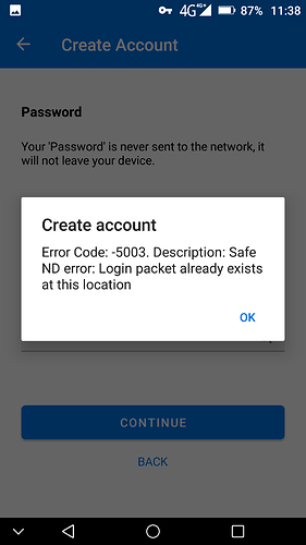

Sat here not recalling password but surprised at error message from authentication one moment and the more usual wrong password the next. Possibly the difference is the username didnt exist first attempt and needs a message for that.
Just replicated this and it does indeed give you a different error depending on whether you have typed a correct or incorrect Passphrase - if I enter a valid Passphrase but an invalid Password I get the error “Incorrect Password”, but if I enter an invalid Passphrase and a valid Password I get the “…packet does not exist” error from your screenshot above
I would argue that the error should not specifically say what is incorrect in a user’s login attempt as it’s potentially identifying that someone uses a particular Passphrase that I accidentally typed. IMO it should be a generic “Details not found, please try again” type msg.
Will log it in GitHub and get some opinions on it - any1 that disagrees with that feel free to shout out ![]()

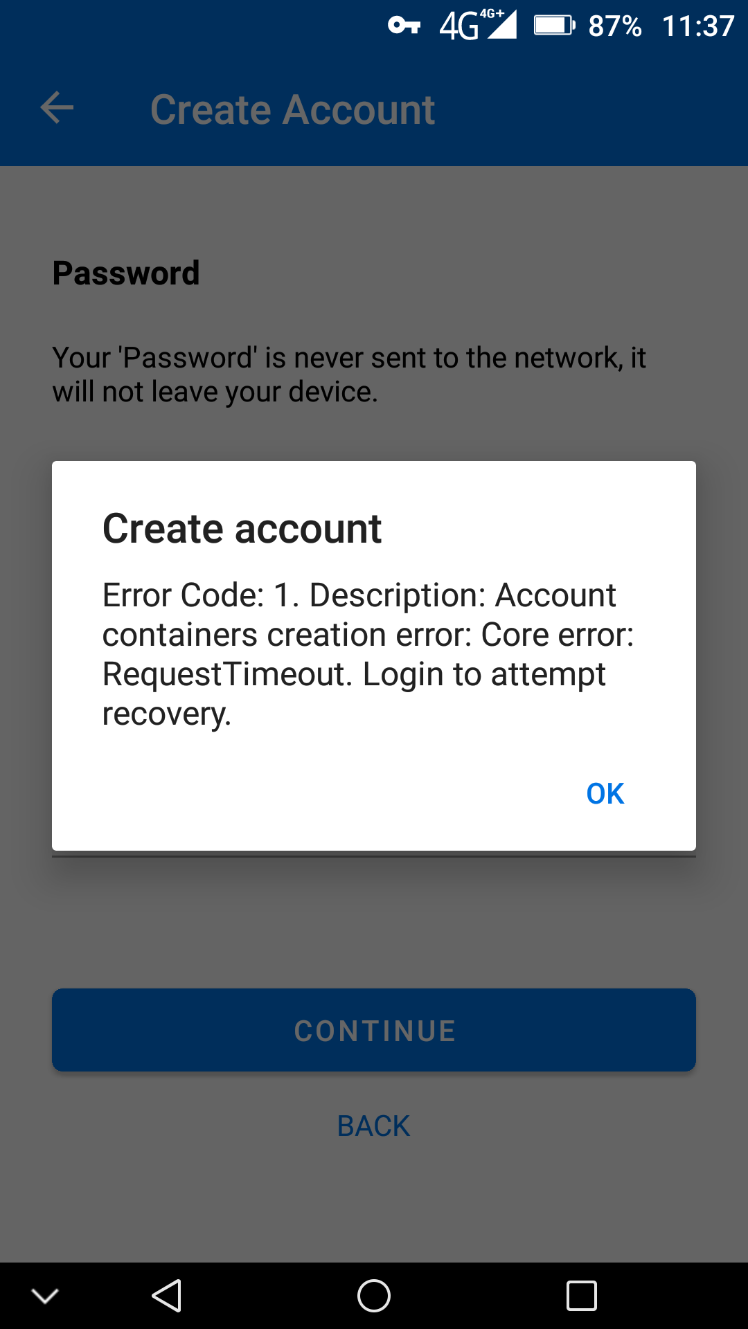

Browser suggests nice a big Error not connected but does not prompt for what needs to occur… refer to point one above… need to know setup required in authenticator and rtfm is a bore!
Then two different errors at the same point, trying immediately after each other …
