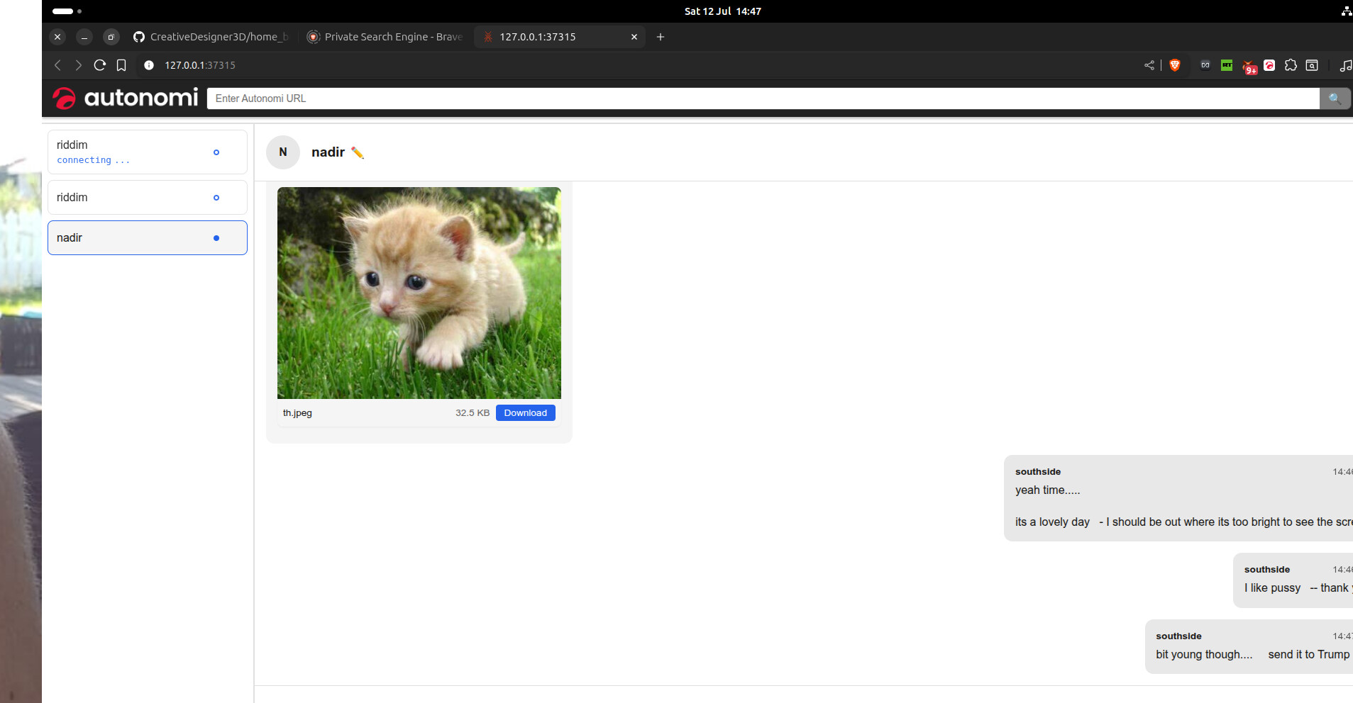

Friends is becoming much more useable
We have passed the pussy pics milestone - and the attachments too
Well done @riddim :slight_smile:
