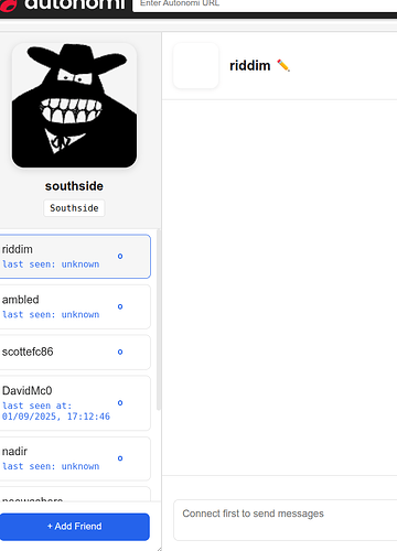

Is anybody online?
Cos all I see is this
hmmm
not seeing issues here … I suspect some old connection info or so is preventing you from properly connecting to the network …
ha! found it …
may you please try a
rm -rf ~/.local/share/autonomi/bootstrap_cache
@scottefc86 ?
Will let you know later on currently digging holes in concrete that was meant to only be 4” deep but is actually 18” :woozy_face:
It worked, nice one :+1:t2:

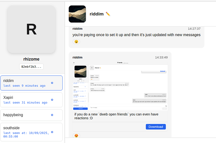

I confirm. Friends is now functional ! :tada:
