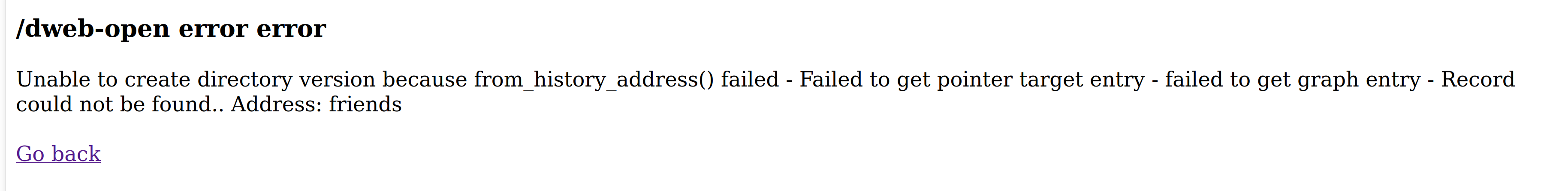

cant get friends to open?
Hmhmm - is the network trying prevent us from celebrating too early again? :thinking:
On ryyn some strange network behaviour has been observed right now too it seems
It may not be that, it is only what at the moment stands out when looking at the logs and trying to understand what that was.
Out of maybe 100 automated runs on network today, running right now as well, there has been absolutely no sign of such issue (or any at all beyond quite slow creation).
But most of those ran several hours ago. I will run a bunch back to back now to get an updated picture.
could be me how do i make sure everything is up to date?
edit: actually i think i am
scott@s00:~$ ant --version
Autonomi Client v0.4.6
Network version: ant/1.0/1
Package version: 2025.9.1.2
Git info: stable / c3dbf09 / 2025-09-03

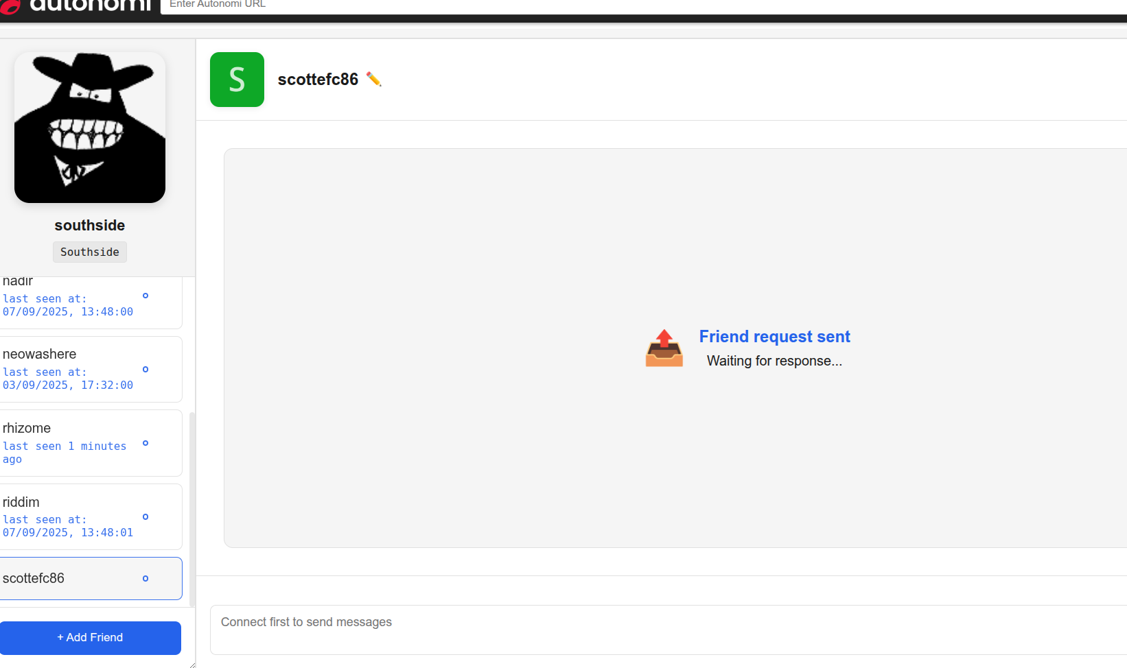

When it’s serving a dweb open friends should do the trick
