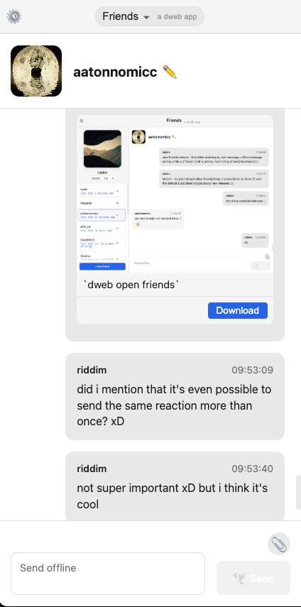

Finally sent first message, maybe took 1 minute, is that normal?
Hi tobbetj, yeah that sounds about right for the first message.
Once the dapp has fully loaded, messages are a bit more seamless, I’ve had a whole conversation with riddim that felt as smooth as you would expect.
I can already see a bottleneck on startup as it recovers message history (especially the more the dapp is used). Not sure what the long-term solution would be outside of cookies and network efficiency boosts, I guess we’ll see how things improve over the coming weeks/months.
yeah … and the solution with scratchpads is not the most idiot-proof store for e.g. list of friends … i think I need to change that to a dweb history type with encrypted content to get a nicer user experience … I somehow emptied my friend list a few times by now by accident …
that whirl of queries on startup could be spread out across time better and the sometimes longish delay to get message history of specific chats back could be improved by using one buffer-pad that spreads across multiple chats (and buffers the last 100 messages of us and our friends to enhance user experience) … so that doesn’t worry me too much … but for sure a lot of work left to make it a proper product …
next steps will be dweb history datatype and graphEntry exposure via API I think … without those the points up my priority list can’t be tackled :wink:
