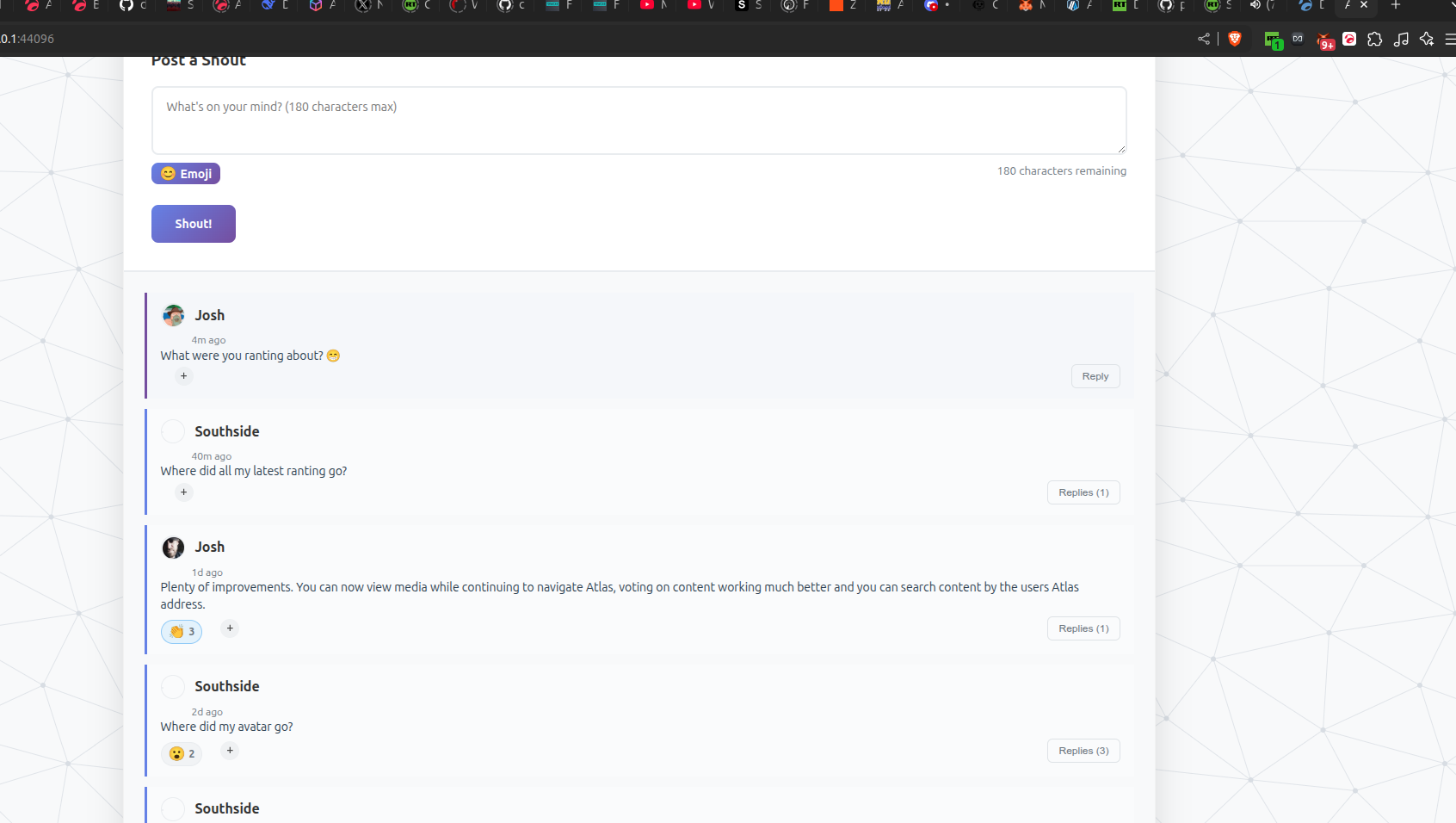

Hmmm
I suppose its our job to fight with it to work out WTF can go wrong so others have a smoother experience..
Nothing I tried to do would display an avatar for the old cartoon me.
Neither the data address nor the archive address.
The comic RankBajin avatar you see uses the data address
f910ee4901637f82694dfa8f2637a51ce7812368b99f2dde5fff94c0b31be624

the blank space next to my name below
And why is my OLD avatar shown next to your name there?
To show you that it works :slight_smile: change it to jpeg. dont ask why, I have no answer.
That was the easy one.. now I’ll try to sneak up on Tovios, I expect, no answer there too :melting_face:

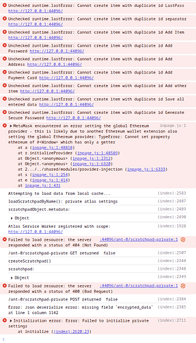

I closed dweb and restarted as per your instructions. Last time and this time Dweb didn’t ask for password and the secret key matches. The balances are as above.
Awesome site works, but neither Atlas nor Scratchchat does. Scratchchat has been working previously, maybe a week or two ago. I may have updated my system in between, but I don’ remember for sure.

Logs from terminal:
Summary

Console output in screencapture. It says something about Metamask. I’m not using Metamask, but a wallet created with Autonomi CLI. Could this be the reason? It has worked with Scratchchat previously.
Hmmm, OK I recreated it. I’ll take the blame for being a naughty boy and not keeping up with dweb changes. :grimacing:
I was still on a older version, now that I updated I see the issue too.
Will get back with you, once I catch up.
