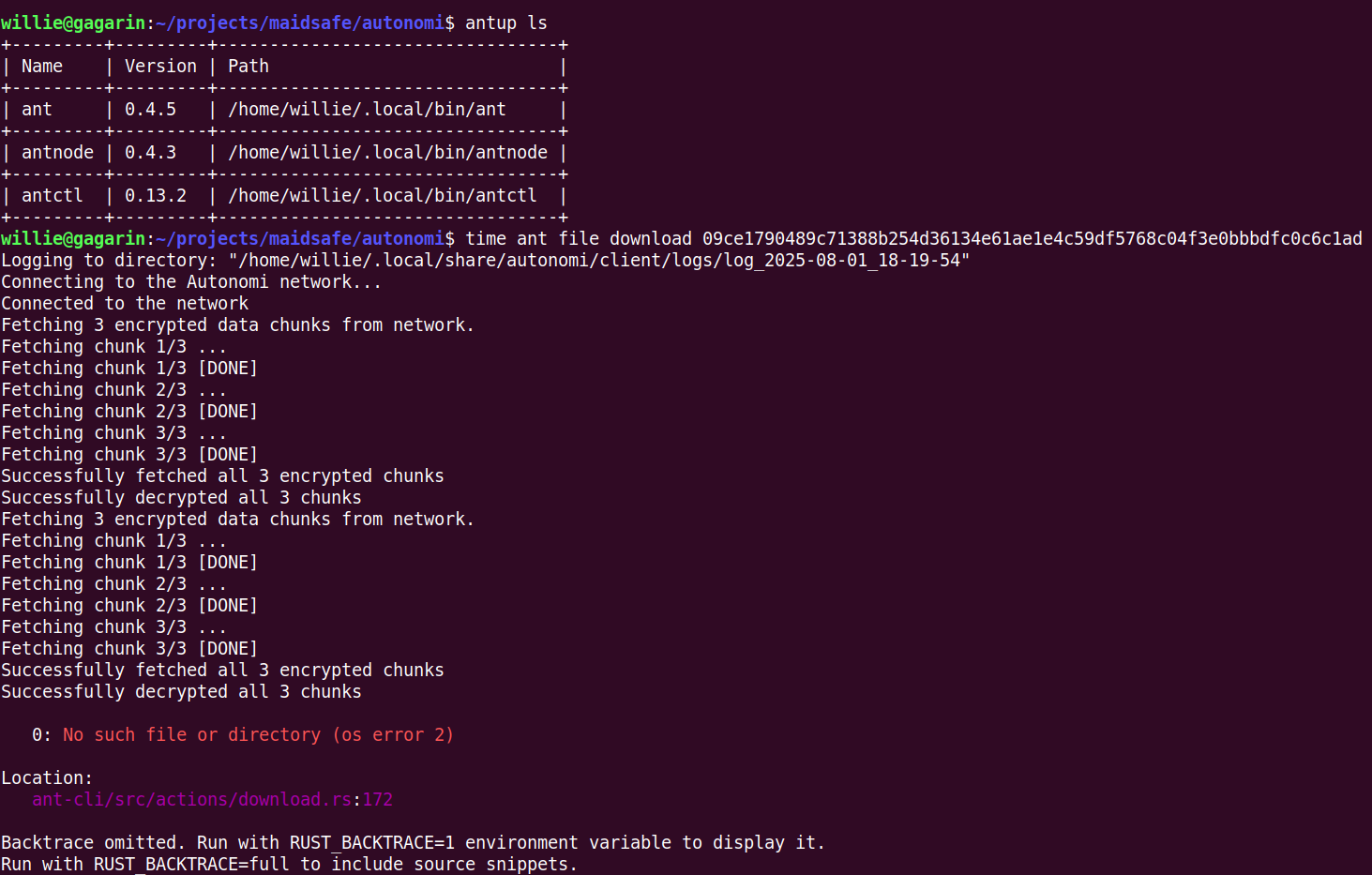

willie@gagarin:~/projects/maidsafe/autonomi$ ant  --versionAutonomi Client v0.4.4Network version: ant/1.0/1Package version: 2025.7.1.3Git info: main / 94d378aa4 / 2025-08-01
My date is later than yours - and then antup update tells me no update reqdthen says I am already on 4.5willie@gagarin:~/projects/maidsafe/autonomi$ antup update
  •      Updating components       *
Retrieving latest version for ant…Latest version of ant is 0.4.5Current version of ant is 0.4.5ant is already at 0.4.5, which is the latest version.No update will be performed.
Retrieving latest version for antnode…Latest version of antnode is 0.4.3Current version of antnode is 0.4.3antnode is already at 0.4.3, which is the latest version.No update will be performed.
Retrieving latest version for antctl…Latest version of antctl is 0.13.2Current version of antctl is 0.13.2antctl is already at 0.13.2, which is the latest version.No update will be performed.
Confused …..but it still fails (if slighly more elegantly) with 4.5
willie@gagarin:~/projects/maidsafe/autonomi$ time ant file download 09ce1790489c71388b254d36134e61ae1e4c59df5768c04f3e0bbbdfc0c6c1ad .
Logging to directory: “/home/willie/.local/share/autonomi/client/logs/log_2025-08-01_18-19-54”
Connecting to the Autonomi network…
Connected to the networkFetching 3 encrypted data chunks from network.Fetching chunk 1/3 …Fetching chunk 1/3 [DONE]Fetching chunk 2/3 …Fetching chunk 2/3 [DONE]Fetching chunk 3/3 …Fetching chunk 3/3 [DONE]Successfully fetched all 3 encrypted chunks
Successfully decrypted all 3 chunks
Fetching 3 encrypted data chunks from network.Fetching chunk 1/3 …Fetching chunk 1/3 [DONE]Fetching chunk 2/3 …Fetching chunk 2/3 [DONE]Fetching chunk 3/3 …Fetching chunk 3/3 [DONE]Successfully fetched all 3 encrypted chunksSuccessfully decrypted all 3 chunks
0: No such file or directory (os error 2)
Location:ant-cli/src/actions/download.rs:172
Backtrace omitted. Run with RUST_BACKTRACE=1 environment variable to display it.Run with RUST_BACKTRACE=full to include source snippets.
real	2m13.728suser	0m0.915ssys	0m0.449s

your git info says main not stable is this a self built binary you are playing with ?
try installing the same version as me
antup client --version 0.4.5
yes im not a fan of the new formatting :rofl:
I have 4.5…..
which ant
