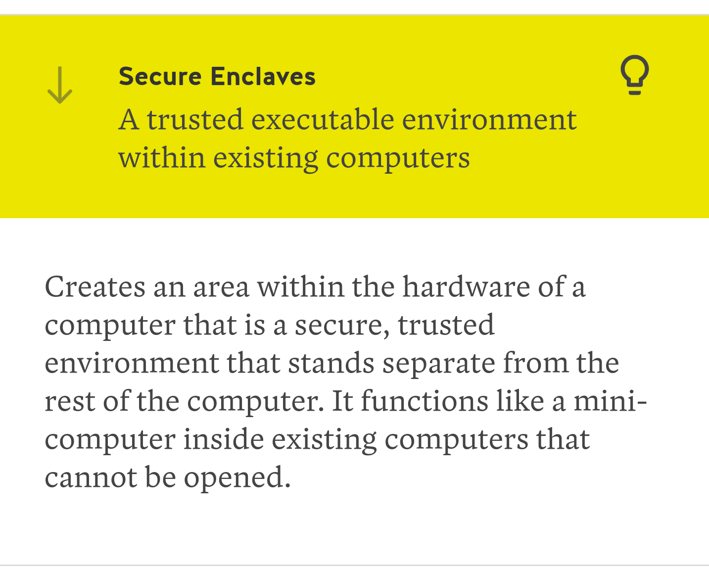

Spotted this on the road map. Compute related?
What I am saying is that who cares who made the APP. Once the APP is there to be run then it has no access to the account of the person who wrote it. Only if the account keys are in the APP would that be possible and stupid too.
Yes that would be talking of compute

It may. This part is to prevent a specific attack on Elders. The key selling attack. It works like this. A bad dude puts up a website to “buy” vault/routing/quic-p2p keysets from people who have an Elder machine. If the people agree to sell these then the bad dude may get to control/stall a section. There are several options open to us and quic and the likes helps (like detecting IP moved and so on) and one option is the routing identity keys are run from a secure enclave. In that way users do not get to see the private key to sell to the bad due.
As you say it makes compute easier as well, as it transforms a byzantine issue in to a crash tolerant issue as we could have code in there that we know is not malicious and so on. This part is more work that just the keys being there.
So not designed out, but it could mean elders must be able to pass remote attestation checks to confirm they have no access to secret keys. It is in the roadmap to allow us to confirm, we wan this and also to check the pros and cons (con being not all cpu manufacturers have a TEE and cross platform capabilities are limited (mind you Microsoft have open enclave)).

Another showstopper con is that all known current secure enclaves have proven to be much less secure than advertised - basically open books thanks to speculative execution attacks. Even if those are patched the future outlook does not look good. The bad dudes offering to buy your keys will also provide the script to scrape them out of your own machine’s “secure” enclave. Leave them running as root with no time pressure. I really hope we find another clever way to address this attack perhaps leveraging multisig…
Yes, this is true, however, it is an option to improve security in some ways. Not blind acceptance of all code in this case, but merely the secret key defence alone. We will get to this, but the economic incentives that also protect miner collusion etc. all make a difference. The secured section messages now buys us a lot here. don’t want to go too deep otherwise we take out eyes of the short term prize, but we can likely detect a malice section and replace it easier than using TEE. Right now I am focused on getting the teams all in the project execution plan and that means a huge focus. So this does not worry me as I think it is very much solvable. As you say though, even multisig helps (BLS is a big win in this industry).

This would not necessarily be the case in any plan. If we ever did use TEE then all I can see so far is Elders would be required to have that capability. So potentially 100% of nodes could not to be Edlers, but 100% of nodes will farm. So it is not black and white, also the open enclave project like others is looking at intel arm and AMD as well as a software only enclave (interesting). So the point here is this is a tool, it need not be blindly applied to all (as that is bad all round), but may be useful going forward. We have not instigated the research project for this yet, but eyes open is important. So digging is good, but we must dig the good, bad and the rest about all these technologies. If you add in AI, etc. there is a lot, but as the network grows it will need to choose wisely :wink:
