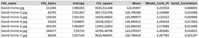

This by means of “ent”, dates from 1985, was built by the “Autocad”-man and measures the randomness of noise signals. Usable on less random material, like audio, images and what have you …
Let’s say I would like to preserve the “MaidSafe-Team-Press-Photos-Pack” for posterity by storing it on the Safe network:
At the time of uploading the file this information is held apart by doing:
for %f in (*.jpg) do ent -t %f
Which results in:
Later on anyone with a need for a portrait of David Irvine specifically under an extended roof would try to select one by checking his elf’s calculations of the distances between the available options:
Used a 15-years old 40-dollar toy to see what would happen then. In a way it seems to work … o/o
