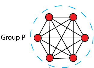

An important RFC from Andreas Flacker about basic design of the close groups. Instead of have a fixed Group_size and each node is member of several groups, create disjoint groups of variable members and each node is member of a single group.
We begin with a group P (something similar to that call clique in graph theory):
as the group grows it will split in two. All nodes will know all members of the connected groups (those who differ only one bit in the prefix).

Nice work! So if I understand well, there’s no need for every node to calculate the routing table from the perspective of the other nodes in the group? In the current case a node needs to calculate 8 X 8 different routing tables and decide who’s close to what isn’t it? In this new way it’s just 8 (or more) close nodes. So when I want to PUT some data, I get quorum size of signs, attach them to my chunk and pick a random node from the group (probably a faster one) to route my chunk forward?? And the next group won’t sign anything at all, they just pass my chunk with the signs to the next group?
With the current approach that’s not even possible: If you’re in my routing table, I don’t know every node that’s in your routing table. Only for the groups I’m a member of can I calculate who the other members are. So if I get a Put request and I am in the close group of the data chunk, then I know who else needs to handle it.
That’s what the current implementation does and it’s not secure.
The RFC suggests that the next group sign it, too: If a group A wants to send something to a group C that it’s not connected to, so it has to send it via group B, then B would check A’s signatures, then sign it itself, and C would check B’s signatures. That’s because C doesn’t even know the members of A.
Possibly with data chains, in some cases we could omit the signing in between. Instead, A could include an old message signed by an old group D (which doesn’t even necessarily exist anymore) saying that A is legitimate and what its members are. If C knew D, too, that would suffice.

A group must have at least GROUP_SIZE members (that are fully connected i.e. satisfy the routing table invariant).
So this can be set by the devs I guess? When it’s decided to be 8 it’s gonna be 8? Is there any testing on this? Like the most ideal number to form a GROUP_SIZE?
The quorum cannot be a constant anymore, due to varying group sizes. It needs to be a percentage strictly greater than 50% instead, and in a group of size n, a number x of nodes will constitute a quorum if x / n >= QUORUM.
Let’s assume the GROUP_SIZE is 8. This means that with 62,5% QUORUM needed exactly 5 nodes need to sign a message. They do this by sending their signs to the closest GROUP (to a target) in the next GROUP. So I’m in GROUP A and want to reach GROUP B with a message. This means GROUP B will accumulate the signs until it has received 5 valid signs for an action? So a GROUP is only as fast as the 62,5% fastest nodes of that GROUP. Is that right?
And the maximum size before a group splits in this case (GROUP_SIZE 8) could be 18 before the split occurs?

Does it make it easier to partition the network if each node is only a member of one close group? Couldn’t you perform a denial of service attack on all the members of the group pretty easily?
To perform a denial of service you need to find out what their IP-addresses are. That’s as good as impossible. There are probably several groups between you and the group you want to target. So the only group you might attack is your own group and/or group that you are close to. At the same time you don’t know which chunks from which files they store. And these chunks might be in cache all over the network. So especially when you request one of their chunks, caching jumps in. So quite hard to target a group I think.
I don’t think the change in group definition makes a difference for denial of service attacks. If anything, it will make it easier to identify misbehaving (e.g. spamming) nodes and disconnect from them. Also keep in mind that nodes won’t just accept a connection from anyone, so an attacker can’t just - even if they know their IP addresses - connect to all members of a group.
The problem is not the misbehaving nodes (dos) but the possible external assault (ddos) that is possible with the knowledge of the complete group. If every node is just one small part of a larger group and does not know all nodes in said group, then such an attack becomes impossible.
Yes, that is a separate problem, but it is an issue in both cases: With the current approach (no Disjoint Groups), every node also knows the IPs of several complete groups.
It will likely need to be addressed in several places (crust, routing, safe_vault …). E.g. with Data Chains, some of the affected nodes will be able to restart when they are ddossed, possibly with new IP addresses but the same node names. The network will accept only the most heavily invested nodes (those that have already done a lot of legitimate work on the network/are storing a lot of data) back in the same place.
