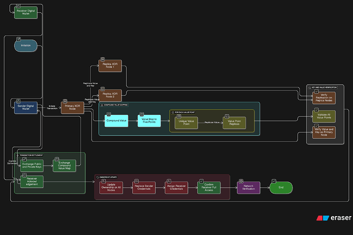

@riddim @traktion please comment and correct.. :wink:
I think we could use an infographic on the above diagramming this properly?
maybe in Archimate 3.0 or UML (draw.io anyone , access from gdocs when creating a new diagram) ?

something like this - generated on DiagramGPT in 15 minutes of command prompt engineering by moi
Share link
