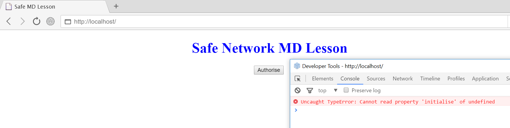

  • try to login with authenticator, spins for many hours with no result (so is there a way I can switch this to mockrouting instead? because I think it’s still trying and failing to access the Test 18 network, not what I want)
  • and then since I’m not logged in, none of the window.safeApp functions work, as can be seen in the screenshot above. Just trying to authenticate my app, but can’t because of the login problem above

You don’t need to be logged in for accessing the DOM API, you just need to have your page correctly loaded from a safe:// or localhost:// protocol site.
From the screenshot, you are accessing incorrectly to your local site. Are you serving your site with a web server? (you cannot load it otherwise, file:// is not supported yet). If you are serving it with a local web server, is it on port 80 or which port?
The way to open your site locally served with a web server you need to use localhost://<anything>:<port> where <anything> is literally anything, e.g. if your port is 3000 then localhost://p:3000 should work.
