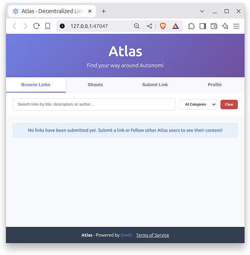

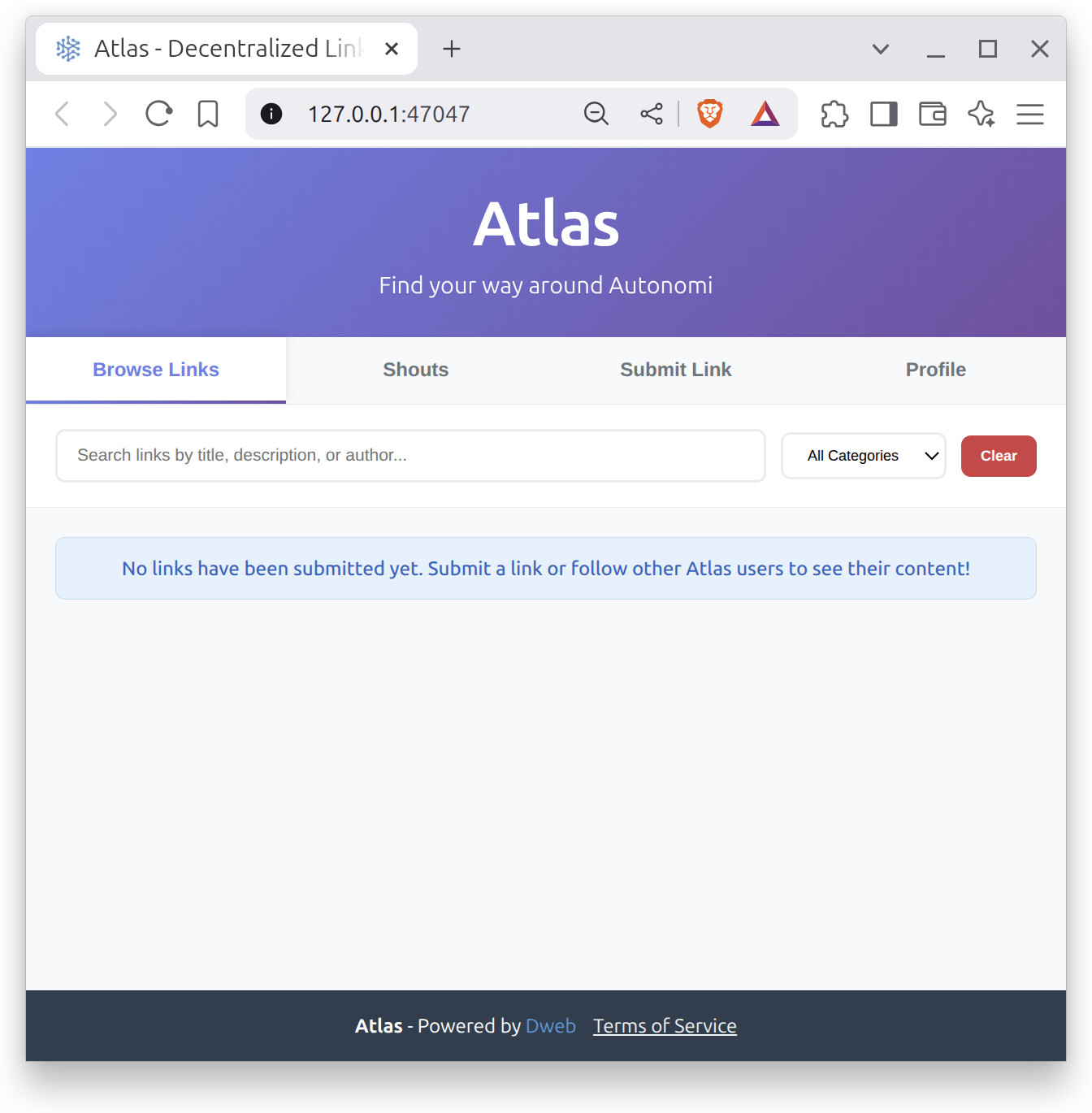

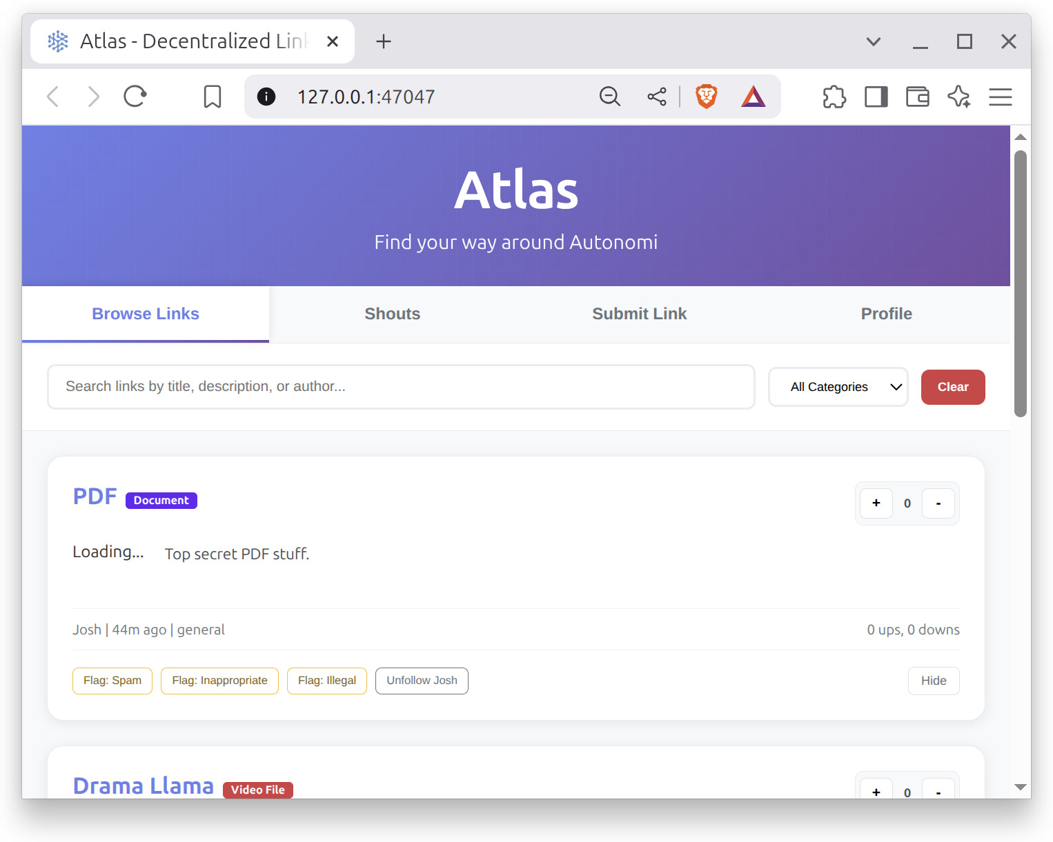

I had a bit of a play with @happybeing’s dweb and made my first Autonomi website. :partying_face:
It just takes his ScratchChat and adds some bells and whistles. Not well tested so probably buggy but if you have used Scratchchat you should get the gist of it pretty quickly.
You will only see content of those you follow.
dweb open atlas
dweb open atlas won’t work for others until I hard-code it in dweb, so you need to publish the History and/or Archive address.

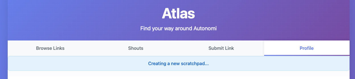

I especially like how it tells you it’s doing something when it does stuff that might take a moment on main
instead of just looking broken :smiley:
