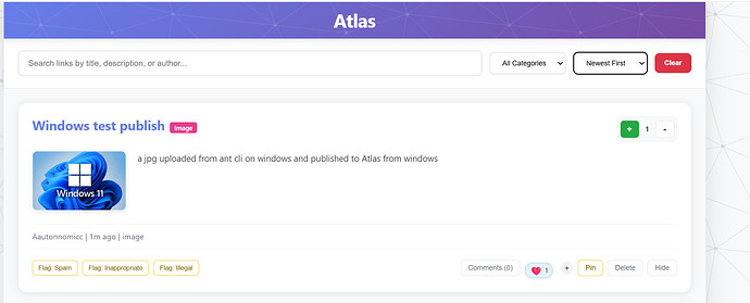

to upload in windows I just did a test of a file called windows.jpg remember the -p to make the file public.
./ant file upload -p windows.jpg
🔗 Connected to the Network                                                                                                                                                                                                                     Uploading data to network...
Encrypting file: "windows.jpg"..
Successfully encrypted file: "windows.jpg"
Quoting for 4 chunks..
Paying for 1 chunks..
Chunk payments of 1 chunks completed. 3 chunks were free / already paid for
Uploading file: windows.jpg (4 chunks)..
(1/4) Chunk stored at: 6f3dcf608cd2bdde23a4a987246f073d531283f308d5c5b5dbb78b473df2377d (skipping, already exists)
(2/4) Chunk stored at: 6858416958fff65e820b2ff9ecf6912000ac8d07dc1439ad49006fa80643a0b8 (skipping, already exists)
(3/4) Chunk stored at: b1b32bdbed143c768b2a23df8d49127a77b18d629ce206909de3ea8f7ee64509 (skipping, already exists)
(4/4) Chunk stored at: d4b95b9577250cfd965eacd0d13778e44ad805efd38bfc6f484c7d4a7799cbfa
Successfully uploaded windows.jpg (4 chunks) to: d4b95b9577250cfd965eacd0d13778e44ad805efd38bfc6f484c7d4a7799cbfa
Upload of 1 files completed in 30.3352655s
Uploading public archive referencing 1 files
Paying for 4 chunks..
Chunk payments of 4 chunks completed. 0 chunks were free / already paid for
(1/4) Chunk stored at: 1a2ef8bb67bbe945b865e6d9e66e4e6bb0beaed33cee8a5e9ad9a596f9872807
(2/4) Chunk stored at: 4bf6ea40b358b5fc335e98eaa402b6d94bbc59f9629f2ae93fdf2ecfc1d433b3
(3/4) Chunk stored at: fe6eeebb8cfbb650dcbf71abc90edf524f72ef3a2465958f55caed0705a96661
(4/4) Chunk stored at: 36246368f2ad4bb707e67f86870874c839a69d1037a201a2c8fdebbc111529c9
Successfully uploaded: windows.jpg
At address: 36246368f2ad4bb707e67f86870874c839a69d1037a201a2c8fdebbc111529c9
Number of chunks uploaded: 5
Number of chunks already paid/uploaded: 3
Total cost: 648196741644 AttoTokens
you want the address from half way up the out put
I just published the image to atlas from windows as well. d-web & atlas are good to go for windows :slight_smile:
