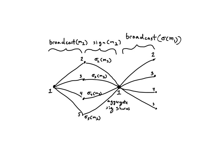

The way this is done in VCBC is through a 3 phase protocol:
- Node 1 broadcasts the message it wants everyone to see
- All nodes check if this is the first time Node 1 has sent a message, if so responds with a signature share over the message:
sigma_j(m) - Node 1 waits until they receive >2/3rd of the signature shares to aggregate into a full signature, then broadcasts the full signature to the network convincing everyone that they all have the same message.
