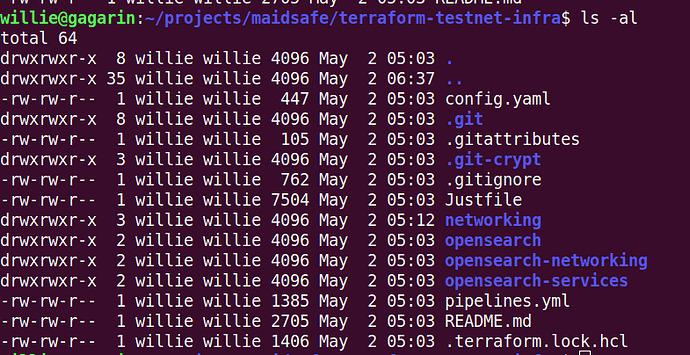

I keep running into permissions problems…
willie@gagarin:~/projects/maidsafe/terraform-testnet-infra/networking$ terraform validate
│ Error: Module not installed
│   on main.tf line 15:
│   15: module "vpc" {
│ This module is not yet installed. Run "terraform init" to install all modules required by this configuration.
willie@gagarin:~/projects/maidsafe/terraform-testnet-infra/networking$ terraform init
Initializing the backend...
Error refreshing state: AccessDenied: Access Denied
	status code: 403, request id: Z4F3RDGT557X9R7R, host id: tnasCI8ib/DU+gXXdxfJH7eNMeks2hzzML+O3QoVbQR43IrGwBaf6mnwJOvyZ+JoDFLmNcp5Gc8=
I can complete the first couple of Hasicorp tutorials so I know I am set up correctly.

I think the problem is here:
This is our bucket, so you need to change the name to one of your own. If I recall correctly, bucket names are global to the whole system, so you won’t have access to one in our account.
Also, there’s an error further down which is indicating you haven’t created the .env file and set your SSH public/private key paths.
Make sure also you have set these environment variables:
AWS_ACCESS_KEY_ID=<your access key>
AWS_DEFAULT_REGION=eu-west-2
AWS_SECRET_ACCESS_KEY=<your secret access key>
This will apply to both repositories.

@chriso - One time again for the stupid, please…
Should I create the .env file in the top level of terraform-testnet-infra?
in here?
like this?
SSH_PRIVATE_KEY_PATH=~/.ssh/id_rsa
SSH_PUBLIC_KEY_PATH=~/.ssh/id_rsa.pub
Have you changed the ID of the AMI?
The default is this:
variable "ami_id" {
  default = "ami-01b8d743224353ffe"
  description = "AMI ID for Ubuntu 22.04"
That should be global to all accounts I think.
