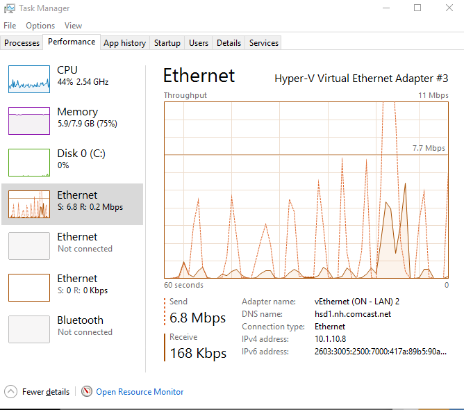

Up and running Windows 10 Enterprise.
No errors after port forwarding.
EDIT: Pretty good upload to private data as well.
