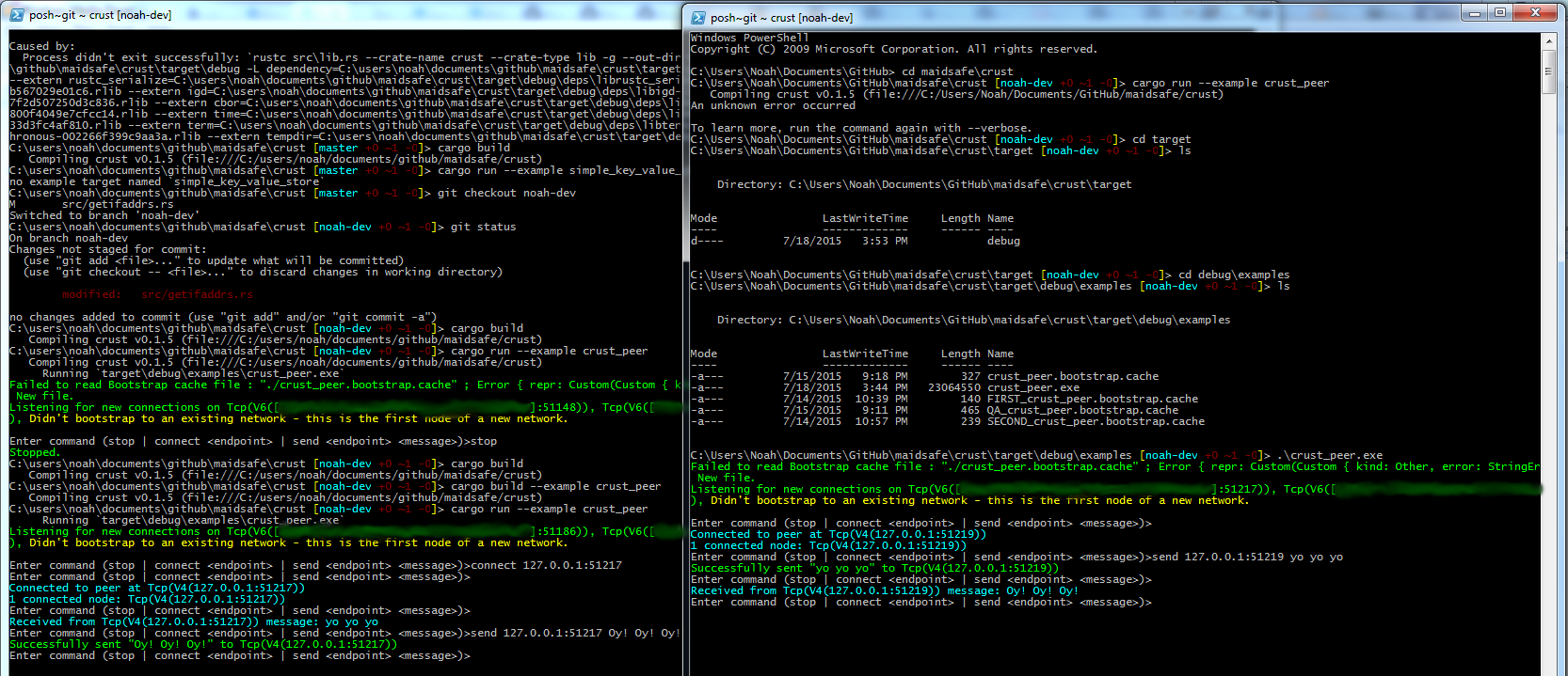

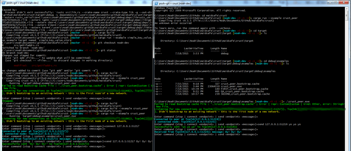

I have been able to “get it running” on Windows 7 32-bit, but this error is the type I have to fix to compile:
Compiling crust v0.1.5 (file:///C:/users/noah/documents/github/maidsafe/crust)
src\getifaddrs.rs:254:40: 254:60 error: trivial numeric cast: u32 as u32. Cast can be replaced by coercion, this might require type ascription or a temporary variable
src\getifaddrs.rs:254 ifaddrs = libc::malloc(buffersize as size_t) as *mut IP_ADAPTER_ADDRESSES;
src\lib.rs:28:24: 28:45 note: lint level defined here
src\lib.rs:28 #![warn(trivial_casts, trivial_numeric_casts, unused, unused_extern_crates, unused_import_braces,
error: aborting due to previous error
Could not compile crust.
This code assumes that in the current environment size_t will not equal u_long in definition, but they are both defined as u32. Since lib.rs adds a warning for trivial_numeric_casts, it doesn’t compile without modification.
I have modified the statement in getifaddrs.rs line 247 to this:
#[allow(unsafe_code,trivial_numeric_casts)]
Now it allows this trivial cast, believe only in the context of the getifaddrs() method, where the issue lies on my platform.
