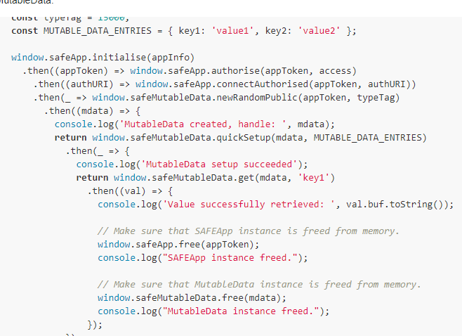

The Maidsafe guys are really great programmers. I am not. Since 2008, when I was last active with JavaScript, it appears that JavaScript has grown up and become complicated. I have slung a lot of JavaScript, back in the day, but when I look at the code below, it is confusing to me.
The above code needs to be split up into about 5 different functions to make it clear to my old brain. If that requires somebody to make a helper library (jQuery for SAFE), than that’s what I want.
Since @Joseph_Meagher is looking for his next challenge, I would vote for that. A library that allows even old-school programmers from 2007 to quickly be able to crank out applications without needing to nest things in the manner shown in the example above.
I know this is my failing and an argument could be made that I need to just come up to speed on the new way to do JavaScript. However, I would argue that there are a lot of people like me, and so having a dumbed-down way for us to create apps would greatly increase the pool of app developers.
I know how you feel Tom, but I urge you to learn the new stuff. What you see above is code using a new feature, which is kind of made for this kind of system: ECMAScript (the JavaScript official standard) Promises
I say… read up on ECMAScript and Promises. It takes a bit of time to get your head around, but without it, it will be far more difficult to build anything a of note. I’m still grappling with it myself, but the alternative is so excruciating now, and the same goes for other new patterns in JavaScript (which are mirrored in other languages such as Rust as far as I can tell).
Thanks for this. You have given me a vocabulary I can use to google things. Also, now I can at least say “I really hate ECMAScript Promises”!
Reading about Promise Libraries, which is interesting and may make my brain hurt less… Lots to catch up on
Also appears it’s easy to mess this up and people frequently do. Here’s some interesting reading. We have a problem with promises
