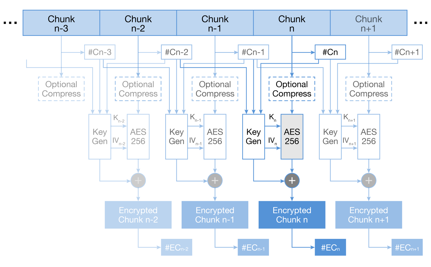

Does SAFE currently use file compression? I didn’t think it did. If it does then guessing compression would have to come first, then chunking, then self-encryption.
Iirc, compression is built into the self-encryption concept/process. It may not be yet implemented though. It makes no sense to not compress the chunks. Bandwidth is almost always the limiting factor, and compute is cheap compared to that. Read the docs :nerd_face:
YEs self encryption does this
→ chunk file
→ Compress chunk
→ take hash
→ use the next chunk hash to encrypt the next chunk
→ Use previous 2 hashes and XOR the next chunk
→ Hash content and make this hash the name of the chunk
So this cyclic process (where the previous 2 chunks data are used to encrpt and xor) continues to the end of the file. At the end the first 2 chunks can finalise and be uploaded too.

Do the current test nets check if a chunk has been encrypted?
As long as it is the client who performs the self-encryption, it is not possible for the nodes to know whether the chunk is encrypted or not.
What the nodes do, in the latest testnet, is encrypt the chunk before storing it on disk.
As for compression, self-encryption use brotli.
