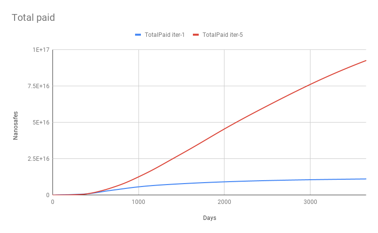

Results
Data points can be found online in this excel.
Discussion
Storage
Filled storage percent f rose up to near 45 % quite sharply and then stayed roughly there all through the 10 years simulated. A slight decline was seen from that point, which is not in accordance with the target of balancing around 50 %, so this would indicate that the models need further work.

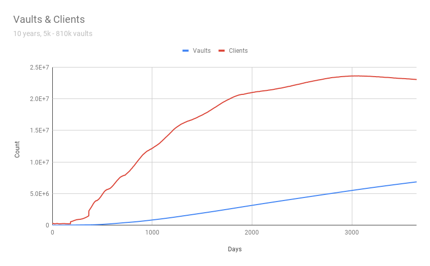

Clients
The number of clients so sharply rising, and then quite steadily falling, is a result of initially very cheap store cost - as determined by the ratio of C to R (this is a model of how cheap C is) and a gradual evolution of the network with lots of uploads, in combination with a modeled decline in users per vault ratio.
One could argue that the decline in users per vault is not realistic. The idea has been that it is due to an increased adoption of the practice to run a vault. It would seem that there would instead be a transition of that initial mass of clients, into vaults, which is not what we see. Instead these clients are in the later stages of the simulation no longer users of the network. A maybe far fetched after-construction, could be that these are users that took advantage of the very cheap storage costs to upload a lot of data, but that later are not using the services of the network to any larger extent. Rather, they just keep their backups, for some undefined point in the future.

Vaults
It would seem like 810.000 vaults in 10 years is a bit of a pessimistic estimation of growth.
Previous simulations have gone up to a maximum of 24 million vaults (and 1.2 billion clients) in only 2 years. Simulations take much longer with that size, and reaching 10 years with such a large population would probably take weeks, and maybe even months or more with a continued growth. It is hard to say what is a realistic adoption rate. But it seems fair to believe the number is somewhere between these two values.
