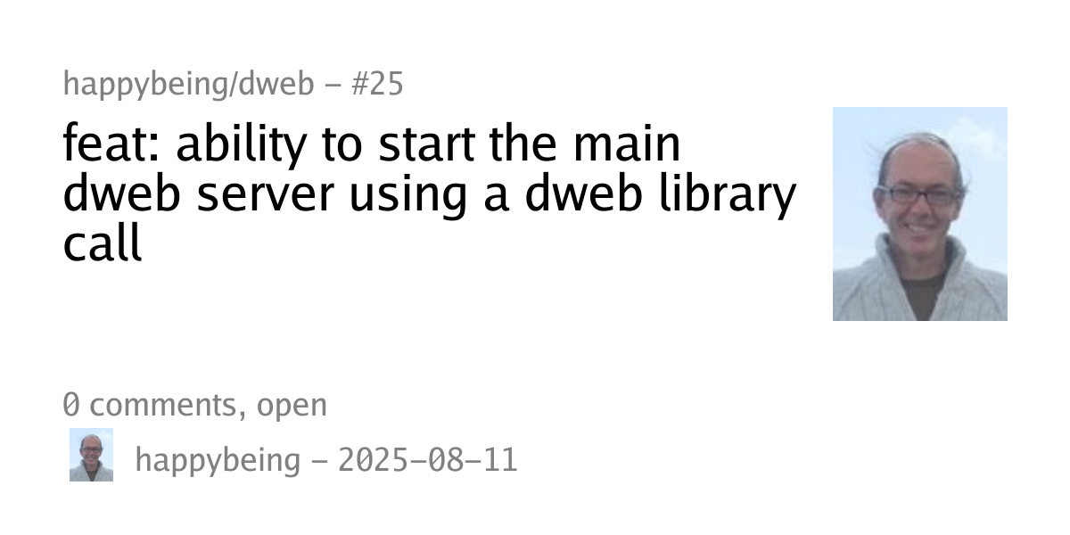

Related to converging REST APIs and the need for apps such as Colony to include dweb services without the need for a separate dweb-cli binary I have created an issue to flesh out plans for both.
Comments and feedback from app developers will be helpful before I make a start on this. @zettawatt @riddim @Traktion @safemedia for sure, but anyone interested in building RESTful apps with dweb, AntTP or anything else for Autonomi might like to review and comment. :pray:
