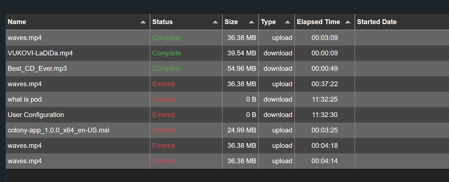

unfortunately I am not a big friend with terminal & logs. No idea how to open the app in terminal on windows and where to find logs. The file is still not uploaded but looking at my ATN account, I already paid for it - how many ANT transactions is normal for such a small file? I have a lot of them.
edit: so it failed after 37 minutes :pensive_face:
edit 2: I successfully downloaded my first 2 files from Autonomi!
Your download seems to be working well. I’m not sure about the upload. I haven’t encountered any failures yet through the GUI with files of that size. I’ll work on better error handling over the weekend to hopefully prevent false failures from sneaking through to the GUI level. If you try uploading the same file again, does it go through on the second time? You won’t be charged again for the chunks that successfully uploaded. It could be it threw errors during the process, but it actually successfully completed. If you upload it again, it may be good. In other words, it doesn’t hurt to mash the button a couple times :smile:

I could not find a way to restart uploading the errored file, so I just simply paid for another upload and finally, it went through! I changed nothing on my end - same machine, same internet connection, I just tried to upload the waves.mp4 for the fourth time and it succeeded.
is it normal for such a small file to have like 30+ ANT transfers?
hmmmm - each chunk is a max of 4 MB - you pay 3 nodes per chunk => 40MB => 10 chunks x 3 nodes == 30 payments (possibly + datamap chunk => 33 payments)
[but should be 1 multi-output transfer … so many recipients but one bundled payment … at least that’s how the ant client does it]
Repeated tries to upload a failed file have long resulted in repeated payments, but I thought that was fixed recently. Maybe it only applies to ant-cli - @chriso can you clarify? Thanks.
oooooh - right - didn’t think about that :smiley: with the current network issues it’s possible that retries hit hard+create additional TXs and it would probably be cheaper for users to wait for the storm on mainnet to settle (especially when trying to upload large files …) …
I believe this is fixed. When I was doing upload testing on alpha net with the colony_uploader, I had it upload some files multiple times and I didn’t incur any ANT or ETH gas costs when doing so. I’ll try again on main net when I get off work.
Maybe there’s a difference between a repeat upload after success and after a failed upload.
ah, good point. I’ll look at that as well.
