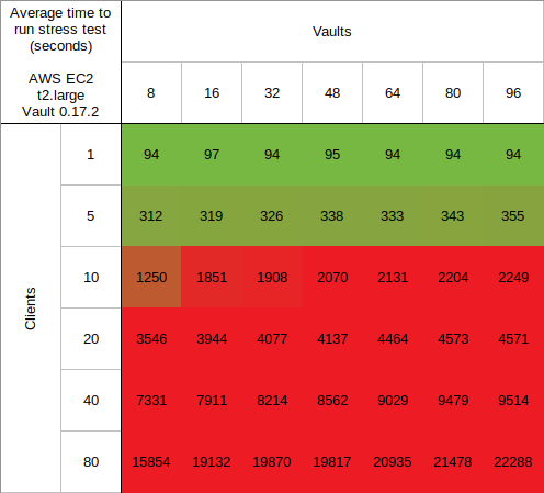

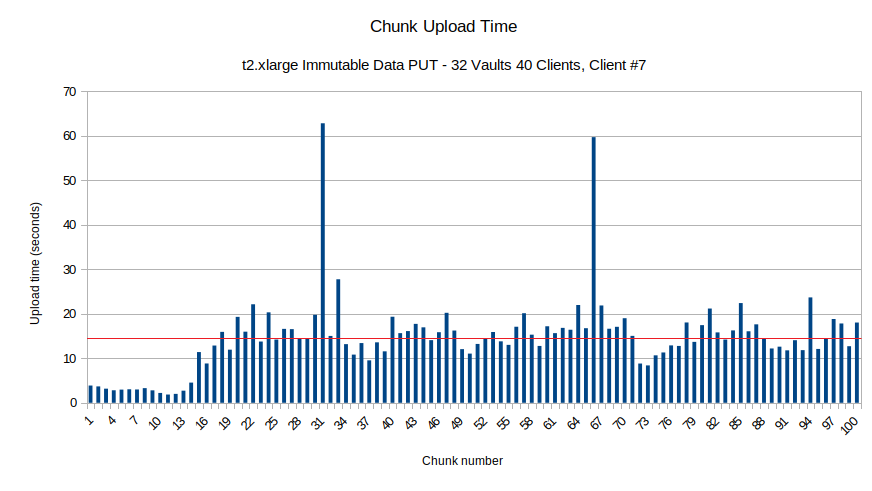

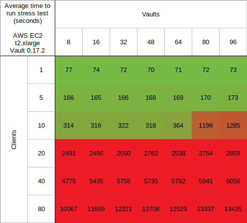

The m5 instances performed much more consistently than the t2 instances as the load increased. The inconsistency of t2 instances is not surprising considering the they’re burstable performance instances. Once the t2 runs out of cpu credits it slows down to about 20% of burst speed. The effect of running out of cpu credits can be seen really clearly in the chart below at around chunk 16 where speed goes from 3s per chunk to 15s per chunk.

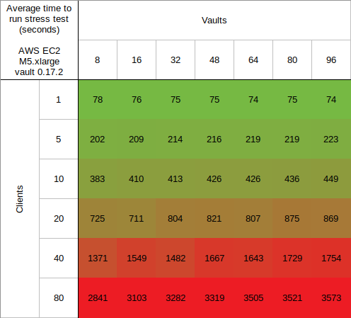

It’s satisfying to see that performance almost exactly matches power for all m5 instances. The m5.2xlarge is twice as powerful and twice as fast (and twice as expensive) as the m5.xlarge.

6 t2.large 4077 0.0928 0.1051

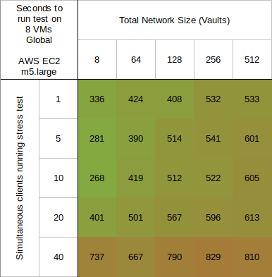

I tried starting up some larger networks on my local machine and ran a single client_stress_test to see how big the network can get locally. It takes a long time to start large networks, so I’ll update this later with additional tests for a 2000, 4000 and 8000 node network. I really want to get a doubling of time from network size.
It’s amazing that increasing the safenetwork size doesn’t add much load. Almost all the work of the safenetwork is spent managing client data, not managing relations between vaults.
CPU load during the stress test was around 50%, same as all other 1 client tests.
There were some vaults that didn’t start in large networks for the reason “All 13 resource proof responses fully sent, but timed out waiting for approval from the network. This could be due to the target section experiencing churn. Terminating node.” There were no sustained spikes in cpu usage and resource proof was disabled in the routing config, so I’m not sure why this happened.
