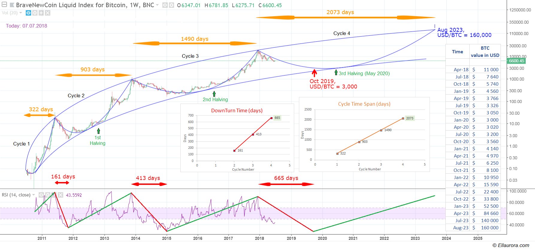

This is the bitcoin mining growth curve (source):
I think this curve is a) incredibly difficult to predict if you’re in 2009, both the shape and the magnitude and b) indicative of possible growth in SAFE (ie uploads, downloads, storage, bandwidth).
Right… we can’t know or agree on the growth beforehand, so let’s design around predetermined growth. Sounds a bit paradoxical.

Below is a modified version of the image you posed above. I used your description of BTC hashrate as an example growth metric. Rather than use wallclock time the x axis is BTC transaction count as a proxy for “network time”. An exponential curve (green) and a fibonacci curve (orange) have been included as example target growth rates.
The BTC growth curve in blue shows a network controller having difficulty maintaining it’s growth target. Under this scenario, a hypothetical control system for SAFE would be pushing the economics to follow the target curve. Below 3e8 transactions, the network would have benefited greatly had the faulty controller offered steady stimulus. From 3e8 to 3.5e8 transactions things are getting too hot and the network controller should have been limiting growth to build up its reserves. From about 3.5e8 transitions onward it should be pedal to the metal since growth is faltering.
In the interest of time this is a rather simple example. As @TylerAbeoJordan intuited above, it’s far better to fit targets and adjust controls incrementally over shorter periods of “network time” to improve adaptability. The chosen duration of the period can also be adaptive and determined by the network. “Optimal Control” is a well studied field in academia.
