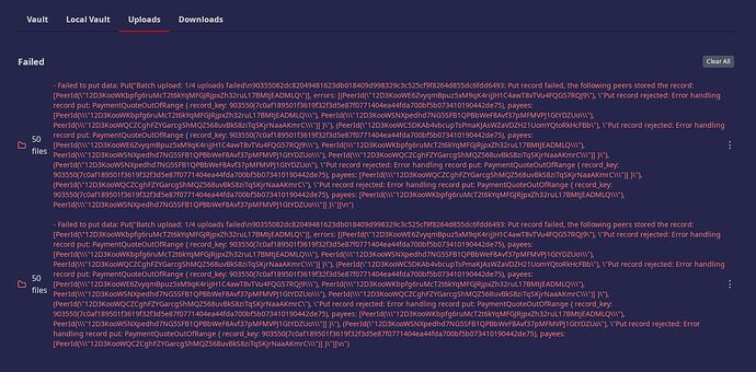

Today Dave and I spent over 3 hours trying to figure out some issues. I tried uploading 52 files in one transaction, but they didn’t upload. I got the errors quoted below. I kept trying again and again — a total of four transactions — and each time the number of addresses receiving ANT decreased: transaction 1 sent to 212 addresses, transaction 2 to 170, transaction 3 to 4, and transaction 4 also to 4. All four uploads failed.
I made a fifth attempt, but I forgot to mark the files as public, so they were uploaded as private — and this time the upload succeeded (I haven’t tested if they download). This transaction paid to 3 addresses.
Then I tried uploading them again as public. Transaction 6 paid to 2 addresses and said the upload was successful, but Dave didn’t show the Data Addresses, only the Data Maps.
I decided to try again from a different address. I made six more transactions there, and every upload failed — each one paid to between 7 and 2 addresses.
At that point I ran out of time because my child woke up. I should also mention that I deleted the bootstrap_cache folder several times during the process.
  • Failed to put data: Put(“Batch upload: 1/4 uploads failed\ne09bb6162eaab413fcbddb287679a7efd350f965c25b0c37e8208aeaca9f2434: Put record failed, the following peers stored the record: [PeerId("12D3KooWCs6nhiPbXEgCnpjeeUYS6vgaquPD7LS7sDPF4LA18k3u")], errors: [(PeerId("12D3KooWMPZzQWQdGcS3oT82TYwg5xSDJ1umxiDVxfFB6K6excex"), "Put record rejected: Error handling record put: PaymentQuoteOutOfRange { record_key: e09bb6(5654e48da81f0235598f2a1d947687934904f585980ff13d95e100c16f3a6795), payees: [PeerId(\"12D3KooWA6RYNs8ri8JXxosxM7VLUycWVACBFM1ZEZ4dNq2Srt5B\"), PeerId(\"12D3KooWRtK2msqYBgeusTsUYwWAuME85GSFeuGvn7TPMJ5ZfVat\"), PeerId(\"12D3KooWCs6nhiPbXEgCnpjeeUYS6vgaquPD7LS7sDPF4LA18k3u\")] }"), (PeerId("12D3KooWA6RYNs8ri8JXxosxM7VLUycWVACBFM1ZEZ4dNq2Srt5B"), "Put record rejected: Error handling record put: PaymentQuoteOutOfRange { record_key: e09bb6(5654e48da81f0235598f2a1d947687934904f585980ff13d95e100c16f3a6795), payees: [PeerId(\"12D3KooWRtK2msqYBgeusTsUYwWAuME85GSFeuGvn7TPMJ5ZfVat\"), PeerId(\"12D3KooWCs6nhiPbXEgCnpjeeUYS6vgaquPD7LS7sDPF4LA18k3u\")] }"), (PeerId("12D3KooWA6FXaAtqdJofvvJSRTTsPXWS3JpZaFbRw59f64kSw8T9"), "Put record rejected: Error handling record put: PaymentQuoteOutOfRange { record_key: e09bb6(5654e48da81f0235598f2a1d947687934904f585980ff13d95e100c16f3a6795), payees: [PeerId(\"12D3KooWA6RYNs8ri8JXxosxM7VLUycWVACBFM1ZEZ4dNq2Srt5B\"), PeerId(\"12D3KooWRtK2msqYBgeusTsUYwWAuME85GSFeuGvn7TPMJ5ZfVat\"), PeerId(\"12D3KooWCs6nhiPbXEgCnpjeeUYS6vgaquPD7LS7sDPF4LA18k3u\")] }"), (PeerId("12D3KooWRtK2msqYBgeusTsUYwWAuME85GSFeuGvn7TPMJ5ZfVat"), "Put record rejected: Error handling record put: PaymentQuoteOutOfRange { record_key: e09bb6(5654e48da81f0235598f2a1d947687934904f585980ff13d95e100c16f3a6795), payees: [PeerId(\"12D3KooWA6RYNs8ri8JXxosxM7VLUycWVACBFM1ZEZ4dNq2Srt5B\"), PeerId(\"12D3KooWCs6nhiPbXEgCnpjeeUYS6vgaquPD7LS7sDPF4LA18k3u\")] }")]\n”)
