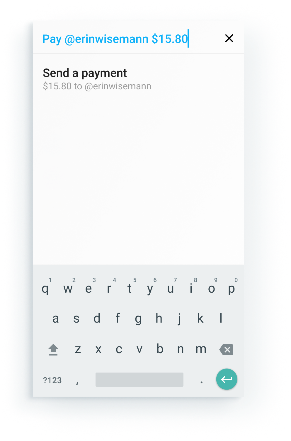

The simplicity of Safecoin payments also goes out of the window. Quick commands like this aren’t doable…
(Heck, that could even be a voice command. But good luck with getting Siri to handle a XOR address.)
