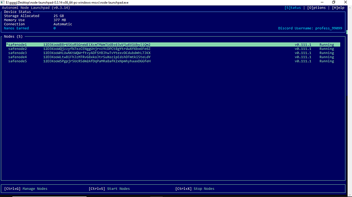

After that I wanted to check the same command with the nodes running, so I launched the nodes using Launchpad:
nodes should work, but after checking the status of the safenode-manager, a message appears that the nodes are stopped and error: access denied:
PS C:\Users\gggg> safenode-manager status

Can this even be the case?
Running the ping command should not cause your nodes to change from “Running” to “Stopped”.
Anyway, now you know that basic network connectivity is NOT one of your problems.
Also I would try to avoid using safenode-manager and node-launchpad on the same nodes. Does launchpad still say your nodes are running?

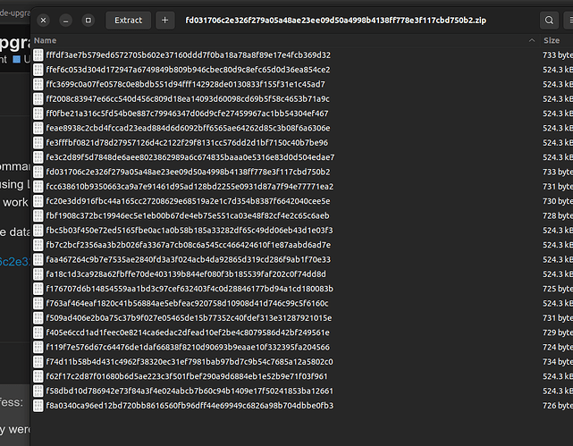

Can you look at your nodes data storage (wherever that is on windows) and see if any records are being stored? Check the date/time for sanity if there are.
The ping command was run when the nodes were stopped, only later was it me who launched the nodes using Launchpad. On the other hand, since they were started in Launchpad, they should also work in the CLI, right?
As far as the data store is concerned, it looks like the nodes are working:
fd031706c2e326f279a05a48ae23ee09d50a4998b4138ff778e3f117cbd750b2.zip (7.0 MB)
THey should. But we have seen the status of nodes being misreported.

You are definitely storing chunks - just not profitable chunks yet

I restarted the computer and found that in Launchpad the nodes are stopped. I can of course do as you recommend but it’s a waste of time to check the old computer, 3 months I fought with it and it still doesn’t want to pay :sweat_smile: :rofl:
