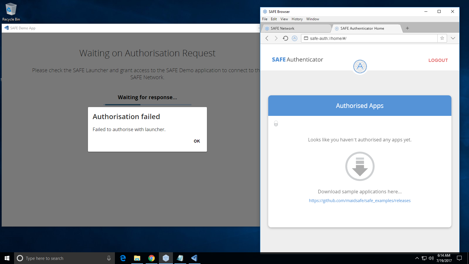

Thank you @maidsafe for all your hard work. This is my 1st time testing as I am very non technical and did not feel I could contribute much during the earlier testing phases. Below is the message I am getting when I try to launch the demo app and I don’t know how to fix it. Any help would be appreciated.
Looking at your screenprint it looks like you are not running the SAFE Browser and thus not running the SAFE Authenticator which is integrated in to the browser.
You need to run the Browser and log in to the Authenticator to be able to authorize apps to run. You will need to make an account for the Authenticator as well.
So go back to the main post of this topic and under download get the SAFE Browser:
Then obtain an invitation token by clicking the link in the following text in the original post (click on the SAFE Network logo once the page loads):
Once you are running the browser go to the bottom of the main page and open the Authenticator. There make a new account using the invitation token you obtained.
When you have done all this and are logged in to the Authenticator try running the demo app again.
Basically it is asking:
“Is it really that weak without safeguards against abuse?”
It is self-explanatory.
I could be wrong but I don’t think the Demo App works with the Authenticator - I think it’s still tied to the old Launcher.
I assumed she got one of the “demo” apps that are supplied for this latest test (Web Hosting Manager or Mail Demo). Either way she doesn’t seem to be running the SAFE Browser so that is a problem at least.

I actually did all those steps 1st and then downloaded the demo app from Github from the link provided in the Authenticator. I also had the safe browser open when I clicked on the demo app link in the downloaded folder.
Hi @Safety1st , only the web hosting manager app and the email app work with Test 17 for the moment, we haven’t migrated the other example apps yet.
Please download the binaries from the first post in this thread.

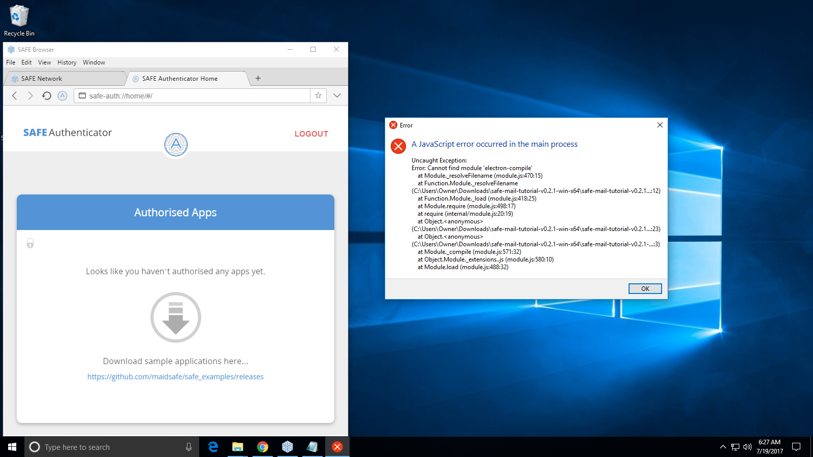

This is the new error I am getting when I try to run the safe mail tutorial. I currently already have java downloaded (jre-8u131-windows-x64) and I don’t know if Java is the cause of the error.

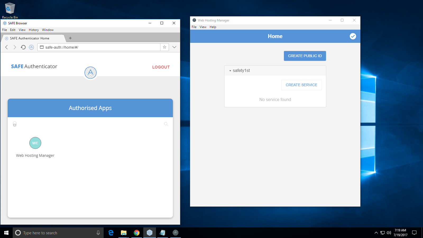

The hosting manager seems to be working just fine on the other hand. :grinning:
