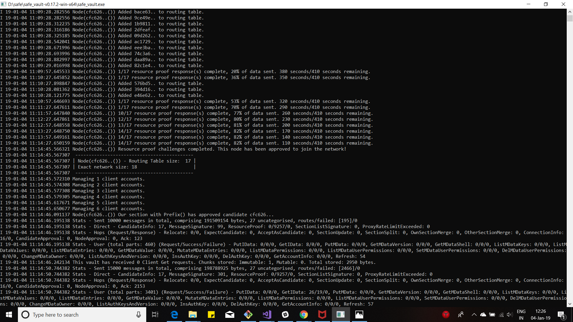

Alright, this one is statically linked with musl: https://home.ebvalaim.pl/safe_vault-linux-arm-musl.zip (at least should be… seems to work on my Pi, and ldd safe_vault says that it’s not a dynamically linked executable, so looks about right
). See if this one works!
Nice one @bart that should be perfect.
Awesome, I will try it out the first moment possible when I wake up later today, thanks bart! ![]()
Could not wait, too exited, looks like it works great. ![]()
I don’t know what happened at the buttom with the “killed”, but now it feels like I’am one step further. ![]()
Did another try and did just notice that there is probably not enough space at the moment, need to solve that, the pi is stuck at 99% load so can’t move the mouse on the pi right now, but hopefully that will get solved soon.
