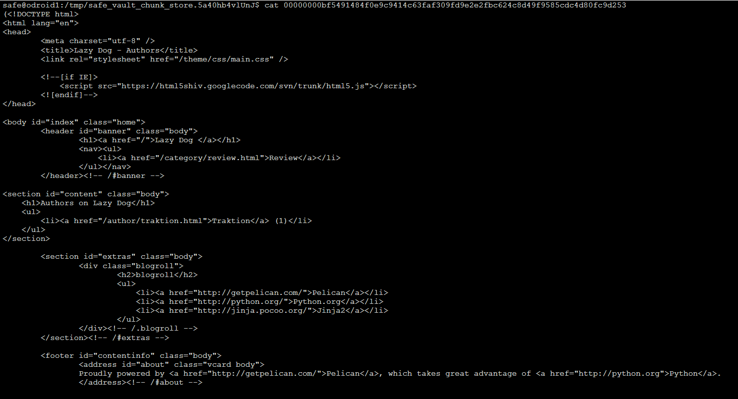

hmmm, I checked some chunks stored on my Vault and I could actually read the content of some. Shouldn’t all data be encrypted? Or does this version of the software not support this yet?
An immutable data smaller than 3 kbytes is not split in chunks and isn’t encrypted. In this case the datamap is the original file itself.
Small private files are always encrypted I may assume?
It’s probably another discussion/thread, but I can clearly see some html pages. Normally this would be fine as it is public, but if the content is something abusive, then I am acutally aware that my vault is serving this and I might even get prosecuted if some agency seize my vault.
(I always thought everything was encrypted, so nobody could know what a vault is actually storing)
Got to say this is a bit of a worry. Small chunks of unencrypted data… what if I am storing bank details, etc… all it takes is a little luck then for someone to spot data that is valuable.
@nevel could you post a screenshot of what you are describing?
Say its not true? :frowning:
Ahh… okay on first glance that looks scary. It is a lot of plain text data!!
But! That looks like publicly available data via website anyway.
What you are doing is sort of like a view source of a publicly available webpage.
I’m not so concerned now.
Comment from devs would be great though.
edit: but! i get what you are saying now. What if this was leaked national security data put up publicly?
You could have every name of every undercover agent in the field, on your hardisk.
Ah, it is a little worrying.
