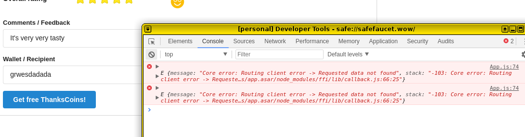

@JPL, so do you have a wallet which public key is “grwesdadada” ? that error seems to indicate it cannot find it.
Yes, I created public/private key in safewallet.wow. Another error occurs with a webID
EDIT, oh hang on I didn’t create a thankscoin wallet - doh.
Yes working now!
Cool, just to be clear, the other type of item you can create in the wallet app for Pub/Priv keys is not related at all with the ThanksCoins wallet type, you don’t need the Pub/Priv key item, those are for storing random key pairs, let’s say you have some bitcoins so you keep the key pair there.
