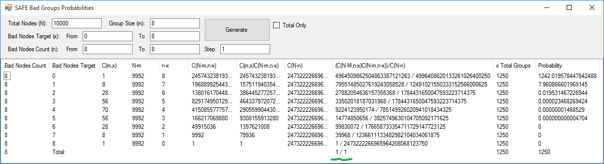

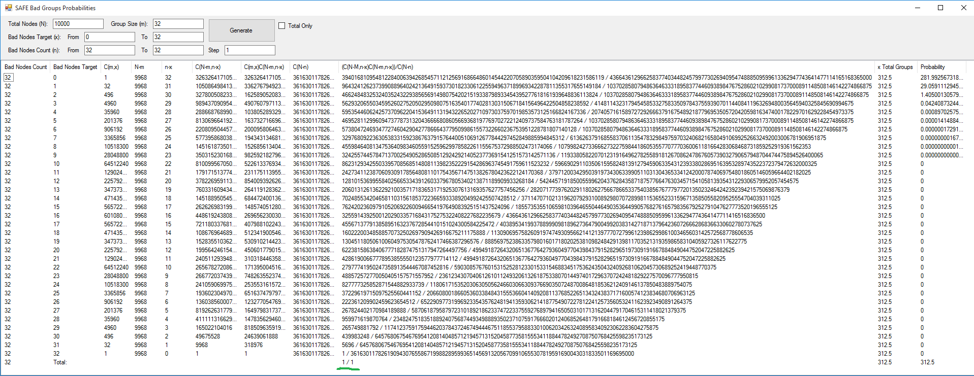

Finally I have done it. I was not able to sleep and it was quicker than I though. But the result is really rewarding and I learn a lot.
Well the presentation is not so fancy. But you can click on any image to access it at full size.
The two first image is a proof that the formula is good. Which have to total 1. Which it’s normal.
Next it’s a sample with all data. To show a little how I made it.
Now the real probability come. The last value it’s the probability and if it’s 1 that’s mean it’s 50/50 chance to happen.
Here is the 28/32 Quorum. Notice at 65% (6500 / 10000) there more than a half chance to be able to control one or more group.
Here is the 7/8. Notice how much more dangerous it is to have least node in a group.
And the last one 8/8. Very dangerous too compared to 28/32.
The conclusion. 28/32 is a lot more better than 7/8 and 8/8 in any way. Maybe thinking about a 56/64 should again be better. Don’t know I didn’t try.

Nice job. Your screen shots are impressive.
I think that your last column is rather the probable number of bad groups because a probability goes from 0 to 1. For example for 28/32 consensus and 10000 nodes the last column goes from 0 to 312. 312 is the number of groups (10000/32), so you can get the probability by dividing the last column by 312.
The last value 1.26 on the line with 6500 bad nodes means that the attacker will probably get one bad group (meaning a group with 28 bad nodes or more). This is the same result I got earlier:
(it was in same context: 10000 nodes, 28/32 consensus).
This is a good sign that our implementations are both correct (yours in C# and mine in Excel).
To be true I still have little doubt about my last column. I can’t find any confirmation on the web about that so I do it the way I think it should be done.
To be certain at 100% to have at least one group. You should have 10000-312.5 (with 32 nodes) nodes. Which is huge.
We are talking about probabilities. If you roll 6 dices, you will probably get at least one 6 but you can’t be sure of that.
Here it is the same: an attacker adding 6500 bad nodes to a network with 3500 nodes (for a total of 10000 nodes) will probably control one group but he can’t be sure of that.
But if he doesn’t succeed immediately, he just has to wait a little because the network reconfigures itself frequently due to an expected high churn rate. It’s like a rapid succession of different networks to be tested.
