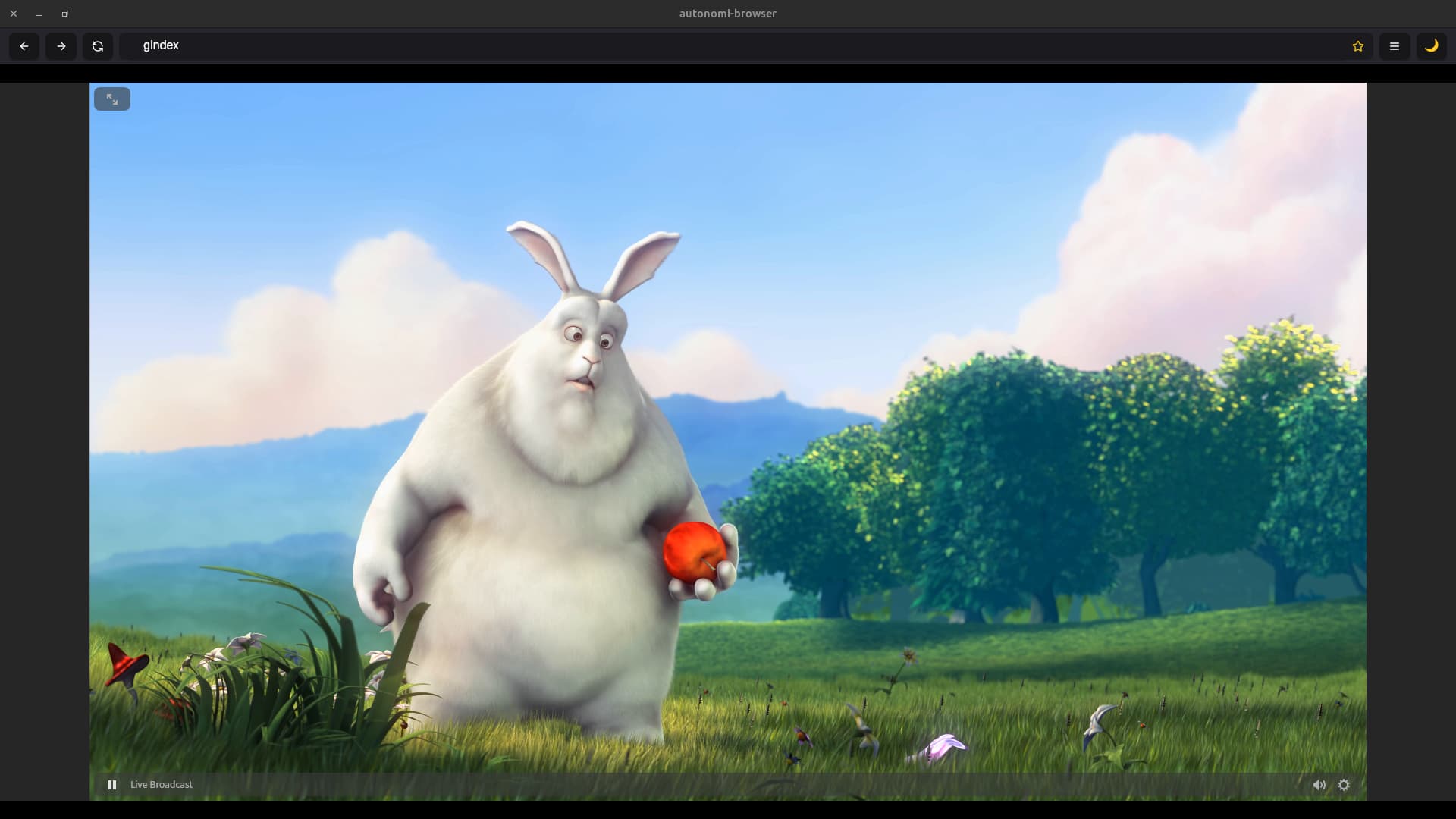

sneak wee preview
yer man @safemedia is getting there :clap:
Not quite ready for primetime yet but its on the way.

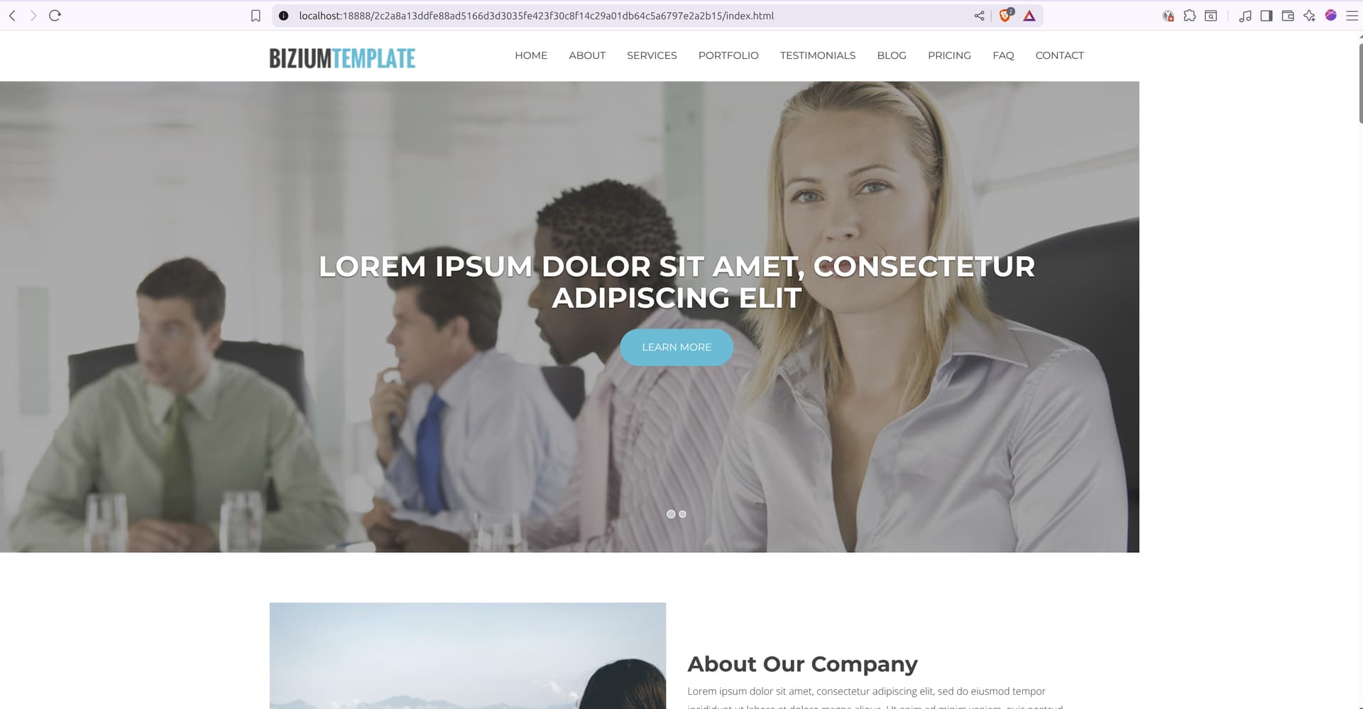

works fine its a you problem :slight_smile:
http://localhost:18888/2c2a8a13ddfe88ad5166d3d3035fe423f30c8f14c29a01db64c5a6797e2a2b15/index.html
